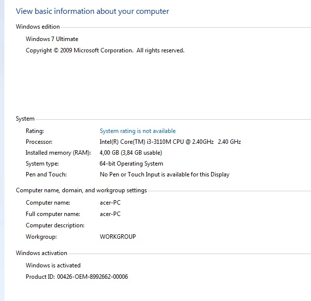

    I have problems illustrator also can not open a new document
    What might be because I do not have enough graphics ?
    I use the internal graphics
    I try to improve as a comment on this forum but still can not open a new document
    Please guide me
