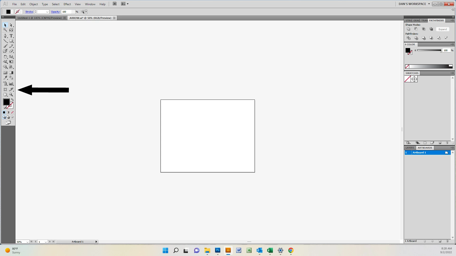

Hello Community.  Thank you in advance for any guidance.  Here is my setup.  I've used Illustrarator CS5 for many years on my Dell Laptop with Windows 7.  Works beautifully.  I just bought a Dell desktop with Windows 11 Pro.  I installed CS5 and it seems to work great.  I am having only 1 unexpected issue; When I double click the 'tic tac toe' icon on the tool panel to resize the artboard, the dialog box appears.  From there, if I change the artboard size, nothing happens.  On my Windows 7 laptop, this works perfectly.  On my Microsoft Surface Pro with Windows 10, it also works well.  On the new computer it does not.  I can close the dialogue box and manually stretch and manipulate the artboard to the size I want it, but it is not 'exact', and I feel like I'm manually doing something that should be automatic.  It's also a huge time waster.  I know that CS5 is not supported anymore, but I love the program and use it all day everyday for my t-shirt business.  Any thoughts?  Thanks a million.  Dan

Which Tic Tac Toe icon are you referring to? Can you please show screenshots?
NA5KARAuthor
September 2, 2022
It's the icon on the far left of the arrow
