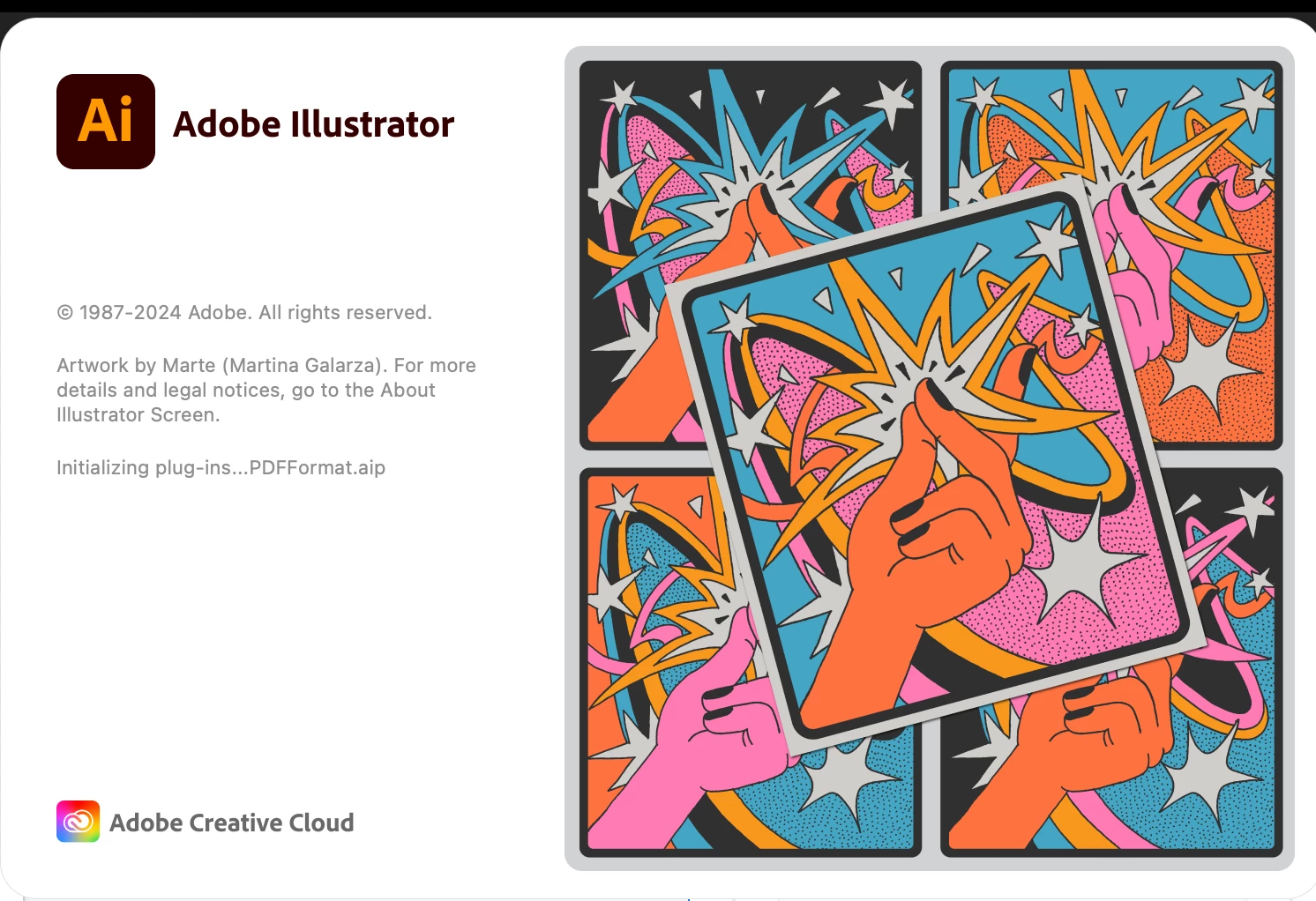

Illustrator Mac 2024 freezes on launch, won't start
It was running fine, then randomly stopped launching. When I try, it gets to the point of checking and initializing, then freezes. Always a different item that it's initializing when it freezes. What I have tried:
  • Uninstalled from CC desktop and from Finder, reinstalled over and over and over.
  • Used the Cleanup tool to remove Illustrator and CC desktop
  • Deleted font cache using Terminal
  • No 3rd party plugins or anything else to remove, no scripts to launch
  • Removed Illustrator caches
  • Removed beta version
  • Rebooted several times
System info:
  • M2 with 16 gb
  • Sonoma 14.4.1
  • System Monitor shows 9 gb free before trying to launch
  • Monitor shows 12 gb used when launch attempt is in progress
  • 95 gb disk available, trash is empty, iCloud is nearly full
  • Other CC apps are installed but not running
Searching here shows this has been an issue for years. Any suggestions before I give up and start using something else?

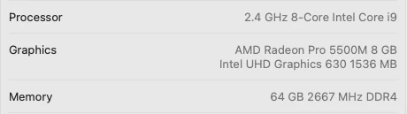

I have just updated all the apps and illustrator still won't start. It freezes as soon as start showing initializing. How is everyone else working around this issue? I'm unable to work.
Monika Gause
Nov 16, 2024 6:27 PM UTC
Please post information about your system.
Additional hardware, Illustrator plugins, system and hardware information.
How many fonts are installed?
yaminichandra
Nov 16, 2024 6:51 PM UTC
602. Most of these are system fonts that are locked.

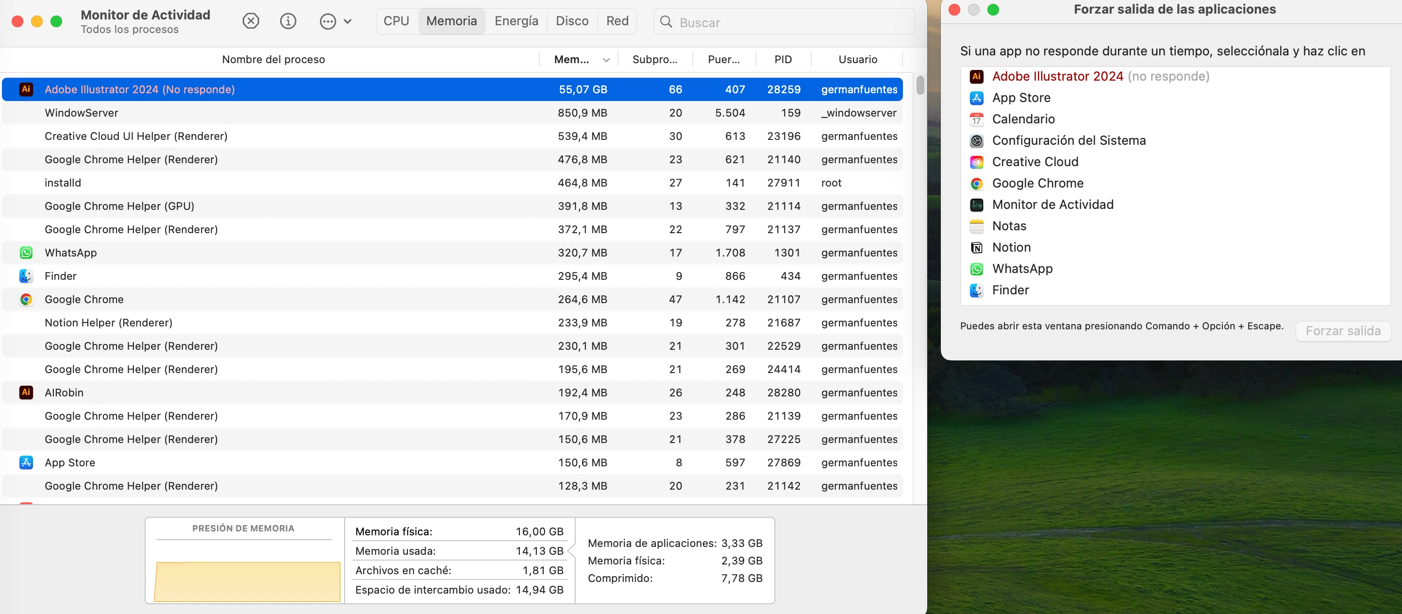

when i open adobe illustrator it is not properly opened and not responsed and when wait my computer outo of memory, and it used 100 GB,  please help how fixed
Ton Frederiks
Aug 11, 2024 4:26 PM UTC
Do you have betaversions installed? If so deinstall them.
