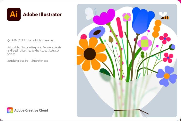

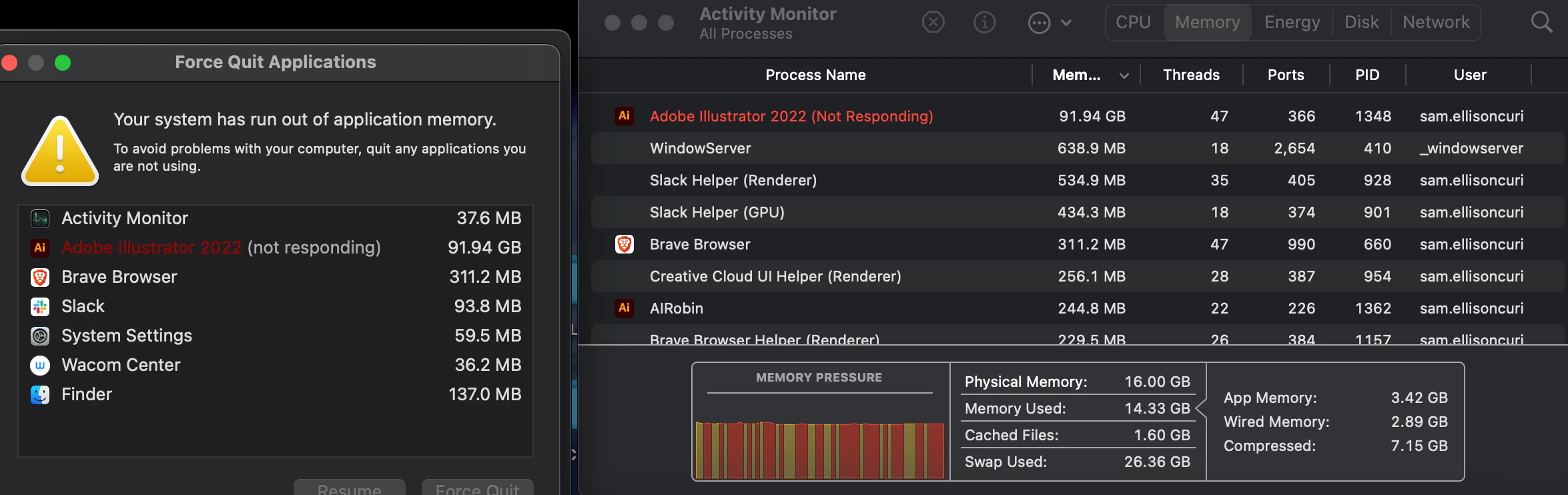

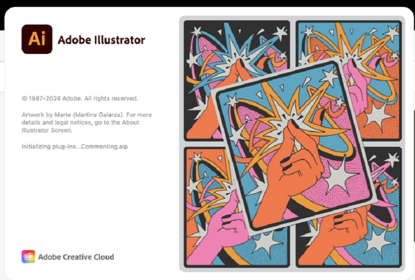

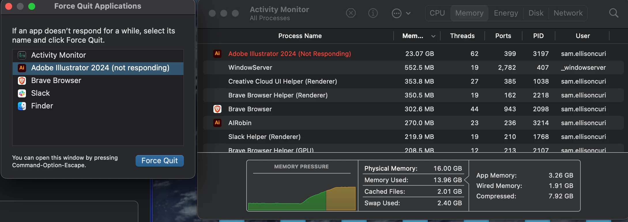

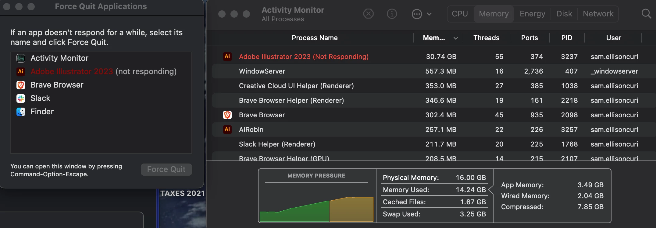

Aug 9, 2024 5:43 PM UTC
  • First--please dont tell me to search the forums as I have been working on this for the week and that advice is not helpful.
  • Second--Apple said to contact Adobe--my computer is fine, we have spent a few days doing diagnostics and this problem only happens when trying to run adobe products.
  • Third I have different versions of some of these programs and use them all for different things as they do not all seem to work consitantly accross builds. I do remove the builds I do not use.
Below are som pictures of activity monitor when trying to launch any of these programs--these are just illustrator but I can provide them from other programs in the suite.
Ai 2022
Ai 2023
Ai 2024

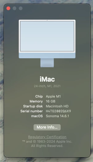

I rebooted, booted in safe mode, ran first aid, empted caches, created ne users, removed programs, stopped things running in the background, etc, thought maybe it was the new MAC OS 14.6 or 14.6.1 but after spending hours with the apple tech folks they said check with Adobe--so I need to contact them but figured I would put this here to see if anyone else is running into these issues.
Working on an iMac
Chip: Apple M1
Memory: 16GB
I do wonder if there are hidden files being created that are being refrenced--but I just don't know.

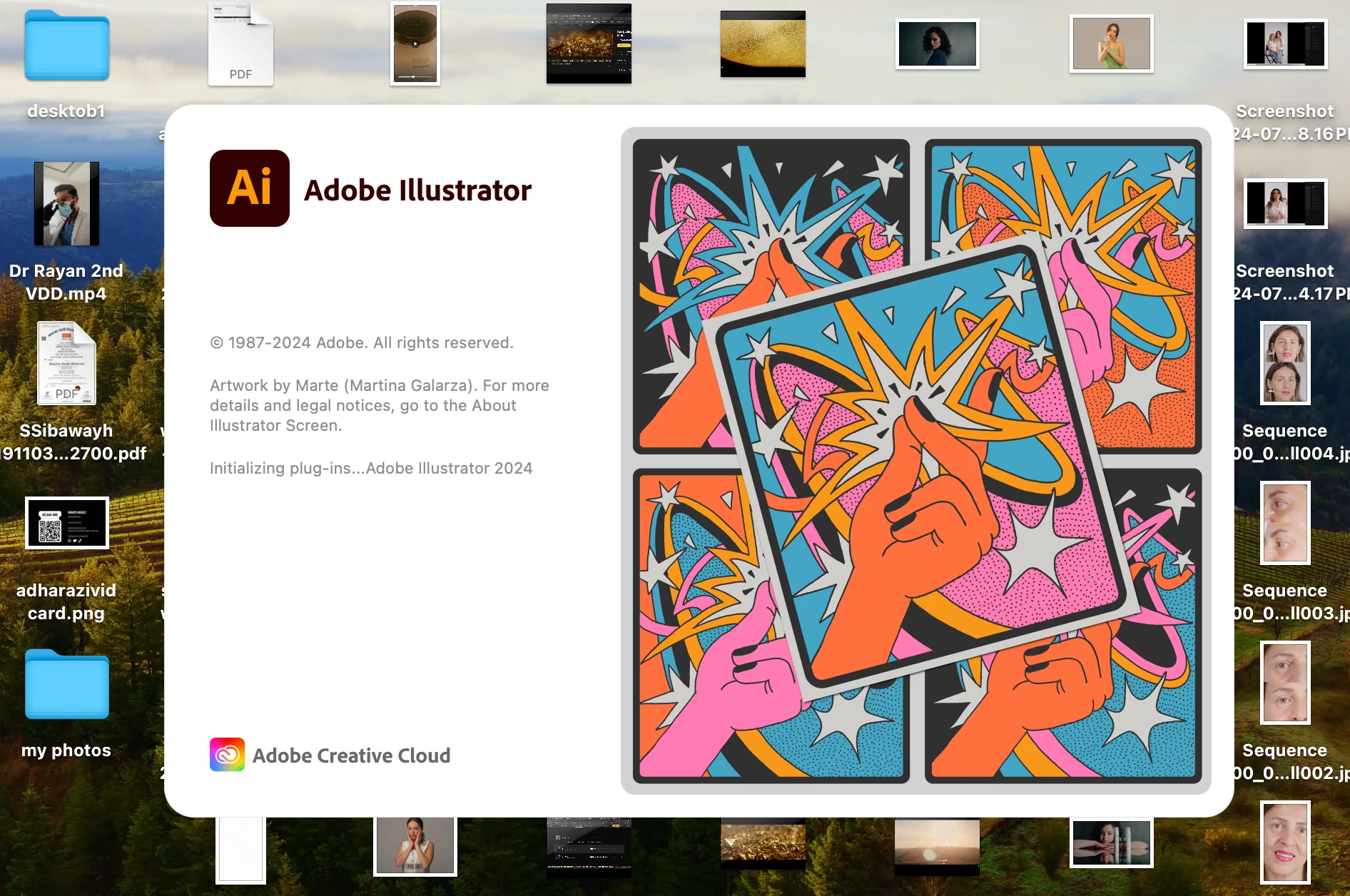

Aug 8, 2024 6:25 PM UTC
how can i fix this problem " Illustrator and photoshop Won't Open (Stuck on Initializing plugins ) but Pr and lightroom are ok" I am using MacBook pro 13 .
Monika Gause
Aug 8, 2024 6:51 PM UTC
Do you have any Adobe beta app installed? If so, try and uninstall it. Then reboot.
