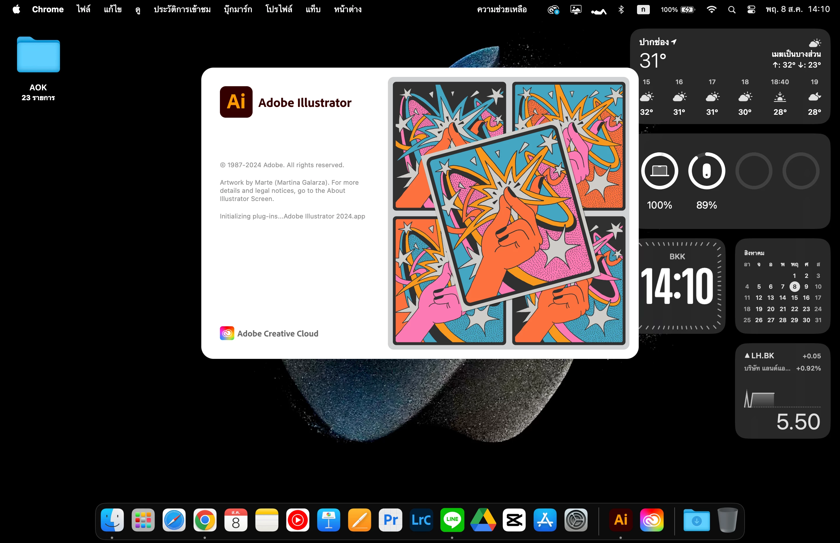

Aug 8, 2024 3:57 PM UTC
As I go to launch Illustrator the pinwheel just keeps spinning and it never opens, any ideas?
Anubhav M
Aug 8, 2024 4:10 PM UTC
Hello @qwishunas4549300,
We understand that encountering technical issues can be frustrating. Would you mind confirming if you have any beta Adobe apps installed on your computer? If yes, kindly try the following steps to check if they help:

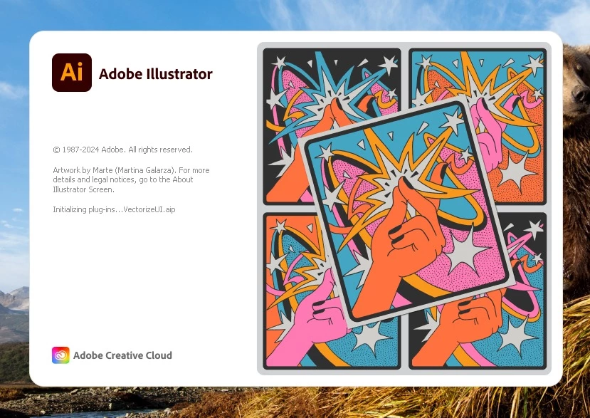

Aug 8, 2024 1:45 PM UTC
the app keep saying intializing plugi-in and doesn't launch
What can I do?
I need help urgently as my client is waiting for the revision...
Please help!
Anshul_Saini
Aug 8, 2024 1:53 PM UTC
Hi @hoiyiu08,
I'm sorry to hear about the trouble you're experiencing. I'd like to confirm that this is an ongoing issue. Other users have reported a similar issue, and we have found that completely uninstalling & reinstalling all beta applications helps resolve it.

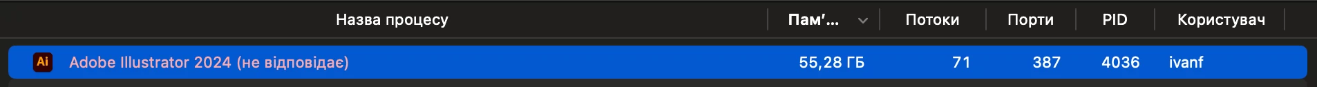

Aug 8, 2024 9:53 AM UTC
Hi! I have downloaded the latest illustrator to my 2023 MAcBook Pro and something weird is happening lately - when I turn the app it instantly takes 26 - 50 GB of RAM and freezes.
I have reinstalled it but nothing helps.
Please assist.
Ton Frederiks
Aug 8, 2024 10:35 AM UTC
Do you have Adobe beta versions installed? See if uninstalling them helps.
