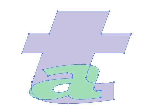

I just started using Illustrator today coming from Photoshop. I am used to seeing the marching ants on anything I use the select tool on. There is no such thing as far as I can see in this program. I have some text I'm trying to manipulate. I have a T over an A and I'm trying to cut out the hole in the A from the T. There is no visual cue that I have selected anything at all. As you can tell I'm quite confused. Any help would be appreciated.

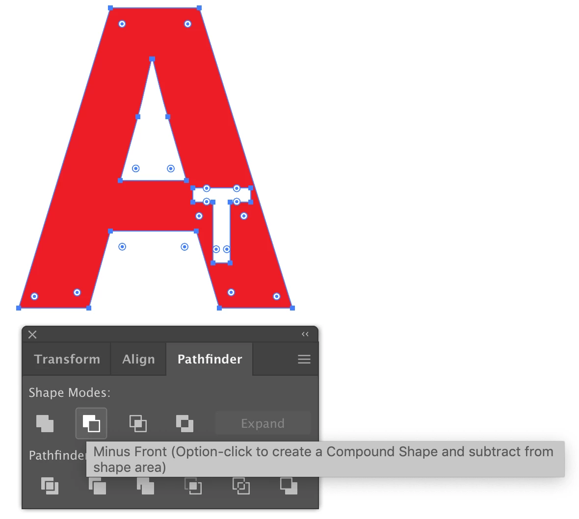

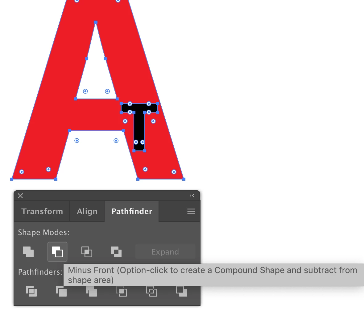

    Adding to Barb’s steps,
    If you want the counter, you need to make it into a separate shape first:
    • Convert the A to outlines, then
    • Object > Compound Path > Make
    • Object > Compound Path > Release
    • Obect > Ungroup
    Note: when you release the compound path, the transparent “hole” will become the same color as the “A”. Change the colors to something else if you want. It will be transparent again when you select the Counter of the A and the letter T and subtract with the Pathfinder.

    We are all guessing at what you want. Can share a screen shot or sketch? If we can understand what you need, we can help.

    4. Window > Pathfinder > Minus Front is one way to cut a hole in the A from the T.

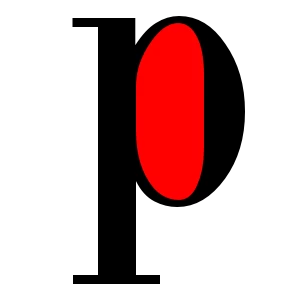

    So what I did now is get a separate image of just the hole in the A and put it on a separate layer. Then I selected that layer and the T and hit Minus front but nothing happens. No hole is created.
