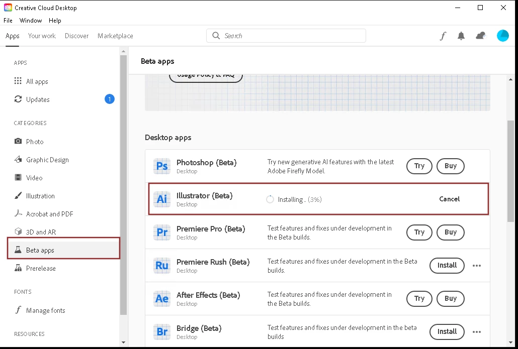

I can confirm that once I installed the latest Beta Version of Adobe Illustrator that I was able to launch the program without the "dxcore.dll" error. I was also able to open multiple documents simultanously w/o issue.
In case anyone else doesn't know how to install beta apps:
Or go to this page and click the link "beta versions of your apps"
https://helpx.adobe.com/creative-cloud/beta.html

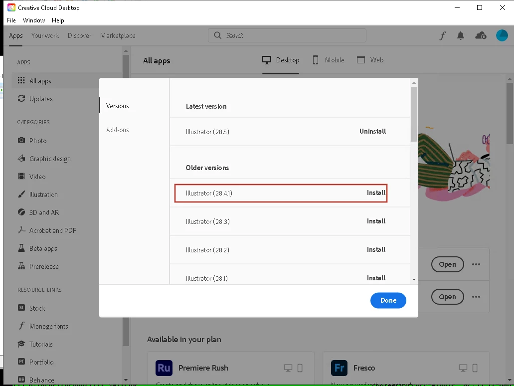

Had the same problem, uninstalling 28.5 and installing 28.4.1 resolved the issue.

Thank you for your patience. Our product team has made several improvements in the latest beta version of Illustrator 28.6 to address this issue. Could you please try installing the newest beta to see if it resolves the problem?

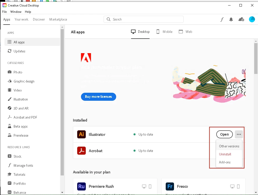

The only work around I found that worked was doing a downgrade to version 28.4.1 using the creative cloud app. See instructions below:

J'ai donc essayé d'installer la version 28.4 avec le Creative Cloud, et ça marche !

Sorry to hear about your experience. Our team has tried fixing this in the latest beta release of Illustrator. Would you mind installing Illustrator beta v28.6 591 or later and letting us know if it helps resolve the problem?

Rolling back to a previous version worked for now. I'm posting in hopes Adobe will take a look.

I was receiving the same dxcore.dll error message, so I uninstalled Adobe Illustrator 28.5 and reinstalled 28.4.1 and I am able to open AI now.  I wonder if there is an issue with the update?  Anyway, I hope that helps you for now.
May 8, 2024
Thank you. Just did the same and it now works.
