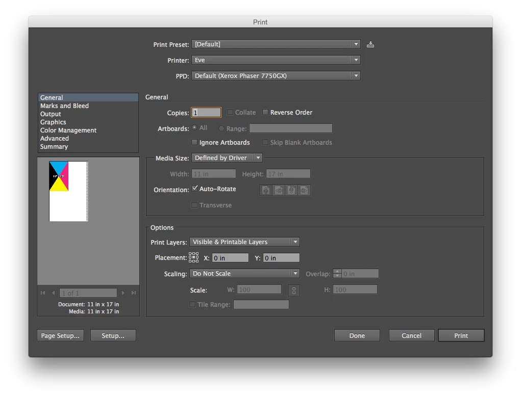

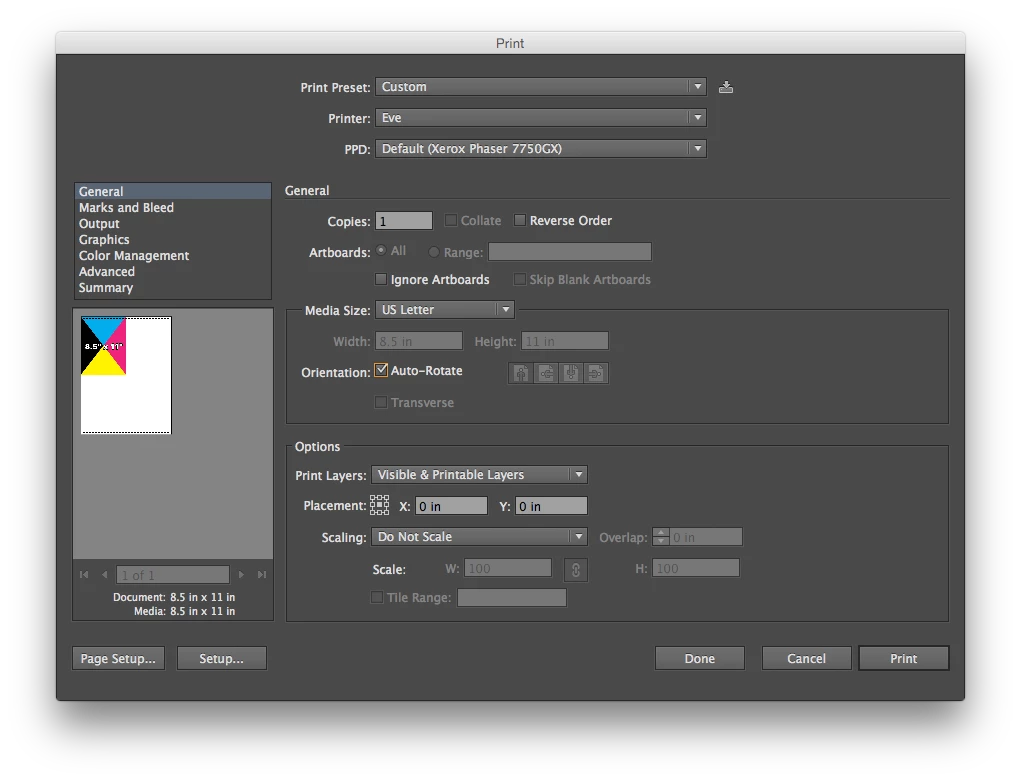

Most of the preview area is gray. The small white box in the preview area is what, in previous versions of AI, used to take up all of the space that is now gray. And only the top quarter of that white box is the actual printable area. The image below is an 8.5" x 11" document that prints properly at 100%:
This next image is the print dialog for a similar document set up as 11" x 17":
Notice that the proportions of the white box changed to match the 11" x 17" paper/artboard, while keeping the top quarter as the printable area.
If anybody can shed some light on how to fix this, I would greatly appreciate it. I may have to revert back to a previous version of Illustrator until this is fixed.

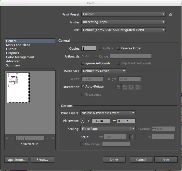

Jan 15, 2015 5:16 PM UTC
lol I guess I have been lucky as I haven't always selected the media. But, I do most of the time. I just went and adjusted that to tabloid, which we usually print on for these types of files. The % for "fit to page" seems correct, but again, the preview is way smaller than it should be.
