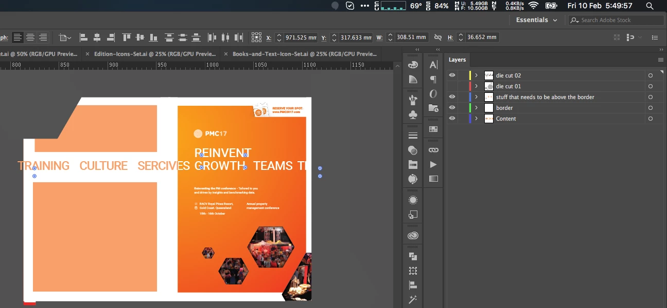

Feb 10, 2017 6:53 AM UTC
In this screenshot, the object is selected and is not able to be unselected. It's selection does not show up in the layers panel. So sick of this frequently occurring bug. Makes the shift to figma/ sketch so much easier.
