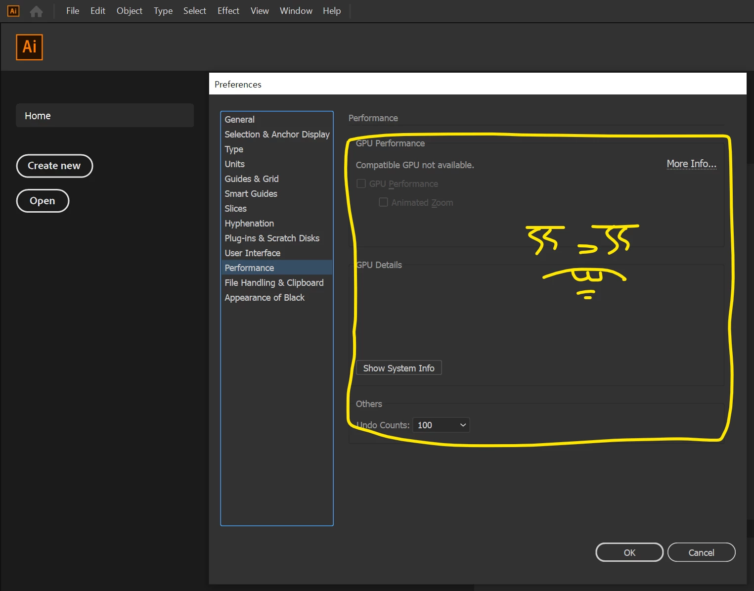

Hello!
as stated in the title

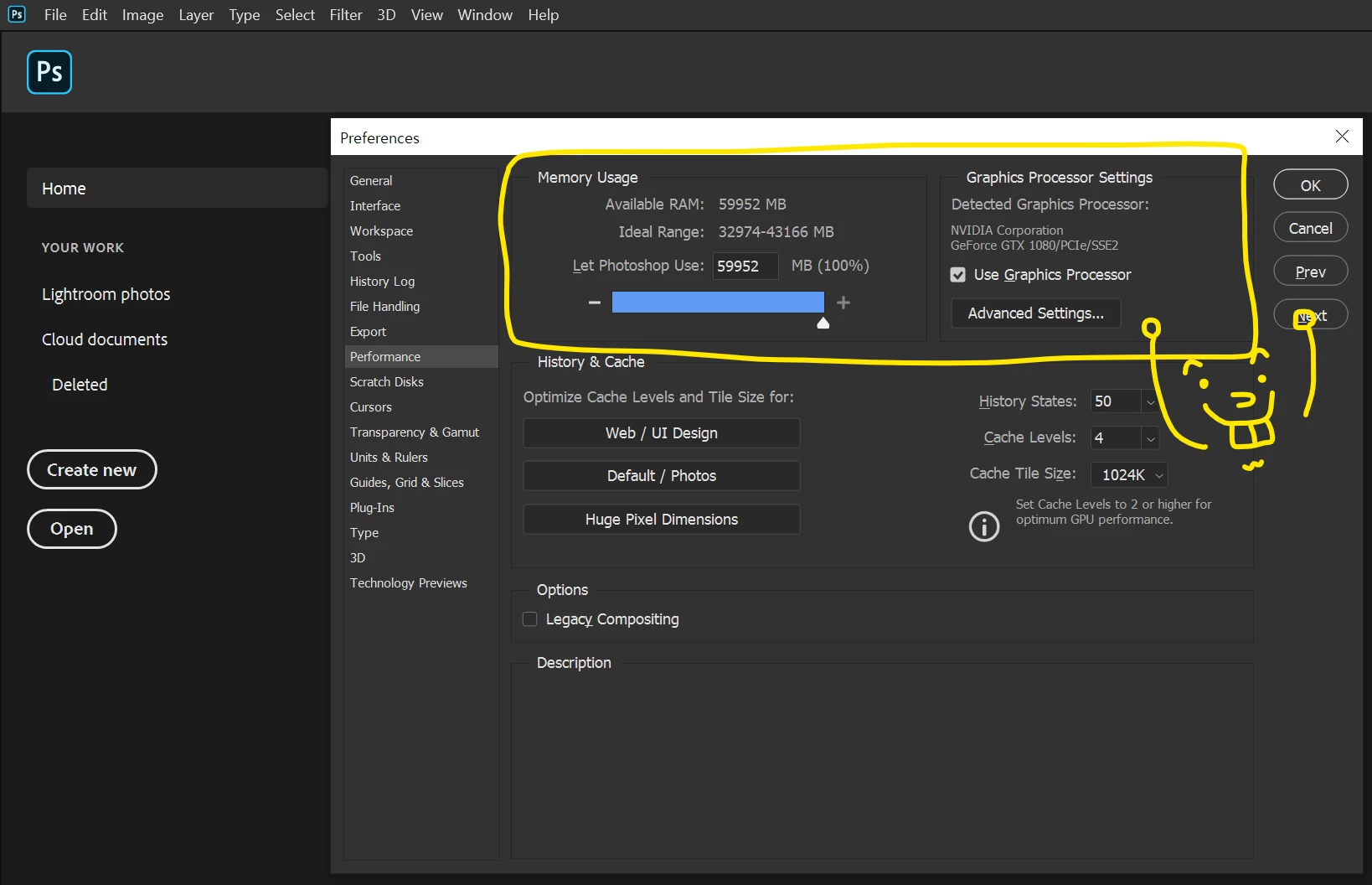

In my computer photoshop, I normally use gpu.
in recognition of
The illustration does not recognize gpu...
I installed the latest NVIDIA driver.
In Computer Settings, the Internal GraphicsHard is:
I've set it to stop working
I don't know why gpu doesn't recognize in illustration only.
Is there someone nice who can solve the problem?

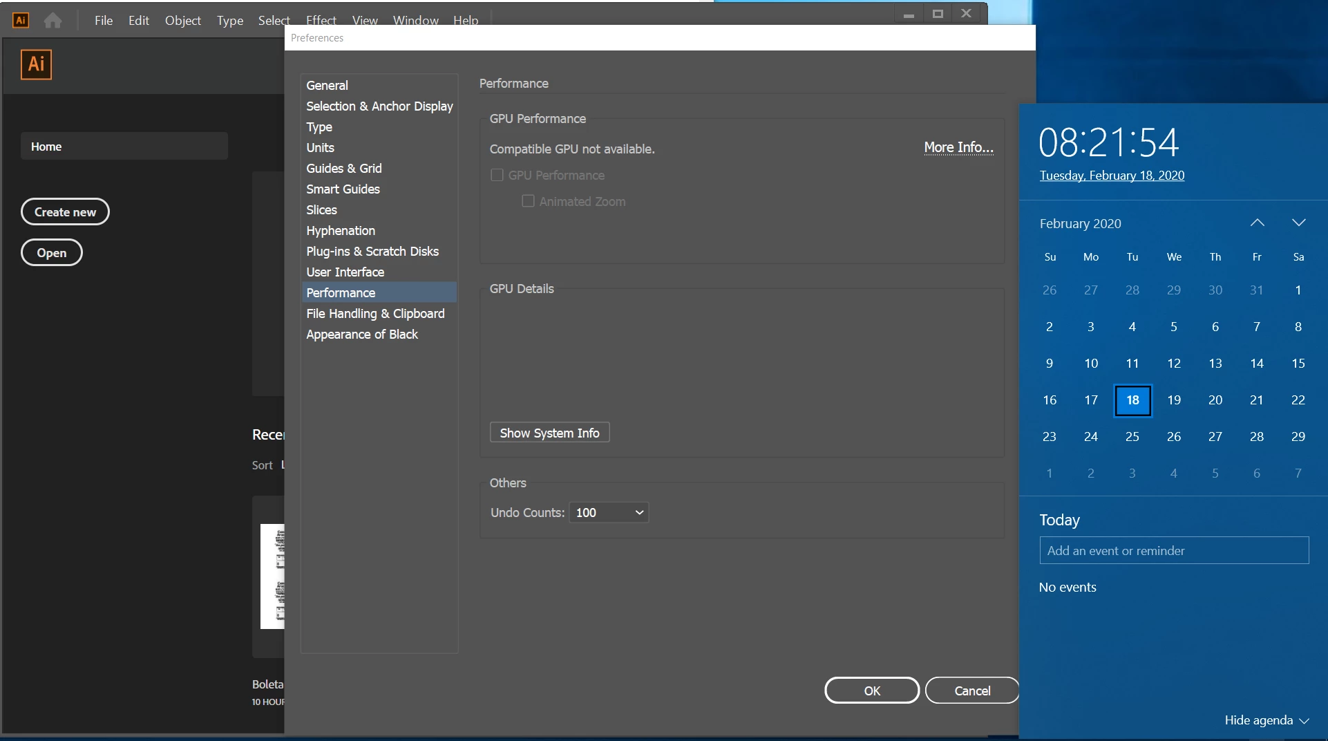

February 18, 2020
Same Problem here. I got like 3 weeks looking for solution to this problem. I use to work with my internal Intel UHD 630 with no problem. Then Nvidia 1060TI with no problem. Now I notice Illustrator stopped to recognize any of my GPUS. Nvidia, Intel, AMD Radeon 590.
I've tried to update my drivers, Windows, the Windows App fix thingy, Lower resolution... etc.
Adobe Photoshop works fine and detects my GPU. So do After Effects, Premier, Cinema 4D...
Illustrator System Info report shows my GPUs: it shows GPUS model, type, mem, displays, etc. This problem has been happening since some time ago to many people with  no reason or solution.
Pls, Help!
assause
February 18, 2020
February 18, 2020
I alse tried that uselessly :'( I reseted the preference on Panel, and also holding Shift/Ctrl. I also disconnected one my GPU. I was about to reinstall windows but, c'mmon, all softwares and the rest of Adobe Suite works fine with my gpu. Forum info is barely useful. And there is not an Official statement that explain what is causing this.
