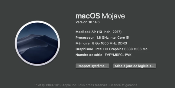

I have a macbook air 2017 and mac OS : mojave version 10.14.6
Illustrator version 25.4.8
