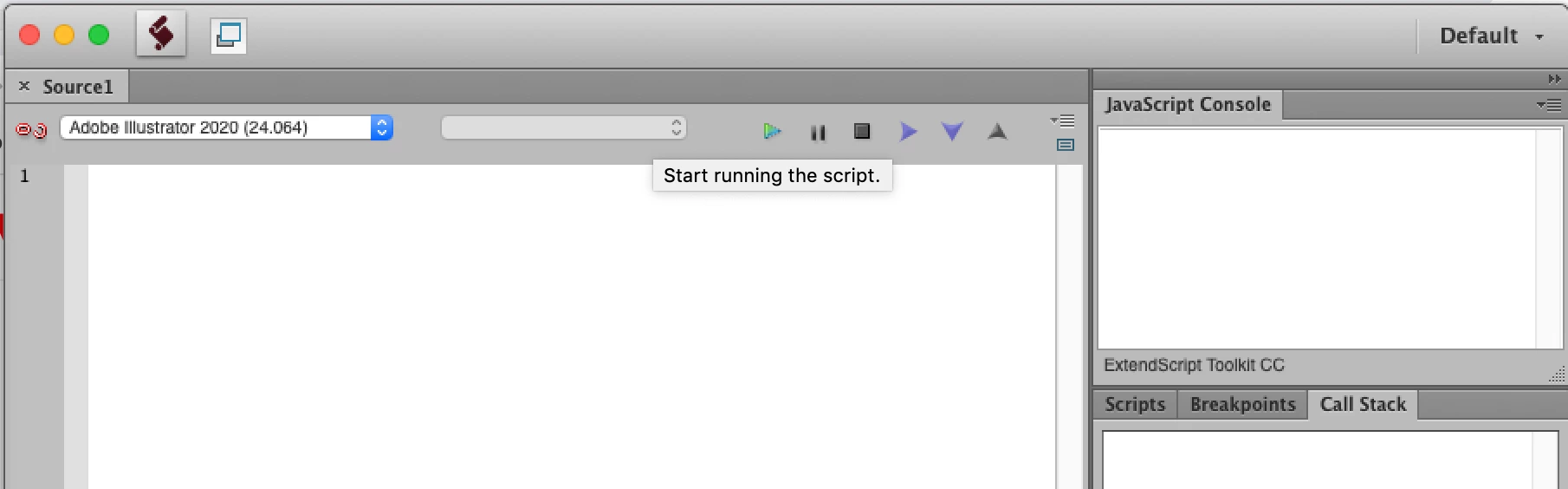

Charu Rajput
Apr 26, 2020 12:51 PM UTC
You need to have Adobe Extended Toolkit. You can download this from the creative cloud application. Apart from this you can use Extended Script debugger for Visual Code. Here is the link with more explanation
https://community.adobe.com/t5/indesign/extendscript-toolkit-cc-in-mojave/td-p/10443284?page=1
After installing it, open this application and paste above mentioned code in the new file. Try to run this script from the menu Debug --> Run. There is a short icon as well below the menu in green color. These file wille be save with the extension .jsx
Attached is the screenshot for the shortcut button to run the script.
Thanks
Charu
