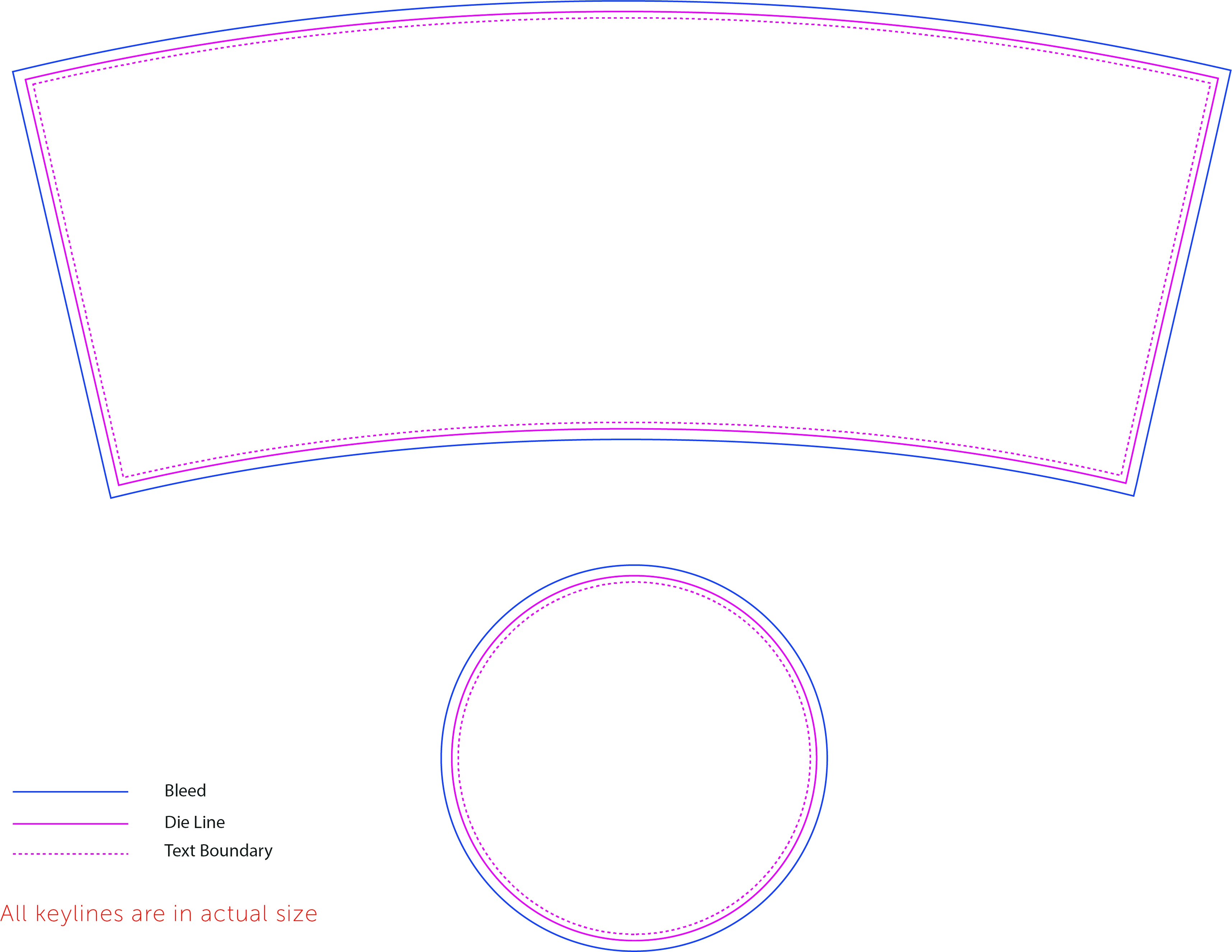

Hi, Jacob. I have been struggling with this for days. So, I got this drawing template from my client's printing vendor. I have several question :
1. The template is not in actual size (much smaller than the actual size), and is a pdf but actually contain embedded image. The design is supposed to be printed in white on a cardboard cup. Will there be issue with the transparancy since I don't think the template is transparent?
2. I can't correctly adjust the arc to the template. I think the template is a bit off (not a perfect arc). I'm afraid that if I manually adjust the anchor point of the envelope distort warp, it will break the distortion since as I said before, the arc is not perfect. So far, I'm working using the template with the not-actual size. I make a 211 x 104,9 mm normal rectangular design, then resize it to a smaller size to fit the template (I set it to 58,56 mm width because it's the width that fit the width of the lower part of the cup), then set the envelope distort warp to 24 percent. But the distortion seems off since I think the template is not in a perfect arc. What is the correct way to solve this? Thank you very much!
Vishnu Thilakan
October 12, 2022
Hello Icehall,
Myself working in a food packaging industry, especially for ice cream packaging. For the last 2 years I have been dealing with these kind of templates. Printers call these as "Keyline".
Now coming to your problem, you need a Keyline with the following parameters.
1. Vector file (Not an image)
2. Actual size is preferred (Although smaller size in correct proportion is acceptable - will have to offset the keyline [path] to correct size)
3. Artwork boundary and bleed seperately marked in the file. (In your template we cannot make sure which line is boundary or bleed)
You better contact the printer directly for these details, also ask them if they need a colour seperated file?
When you have these details (or need further info.) reply here with the Keyline in Pdf/AI.
Vishnu Thilakan
October 17, 2022

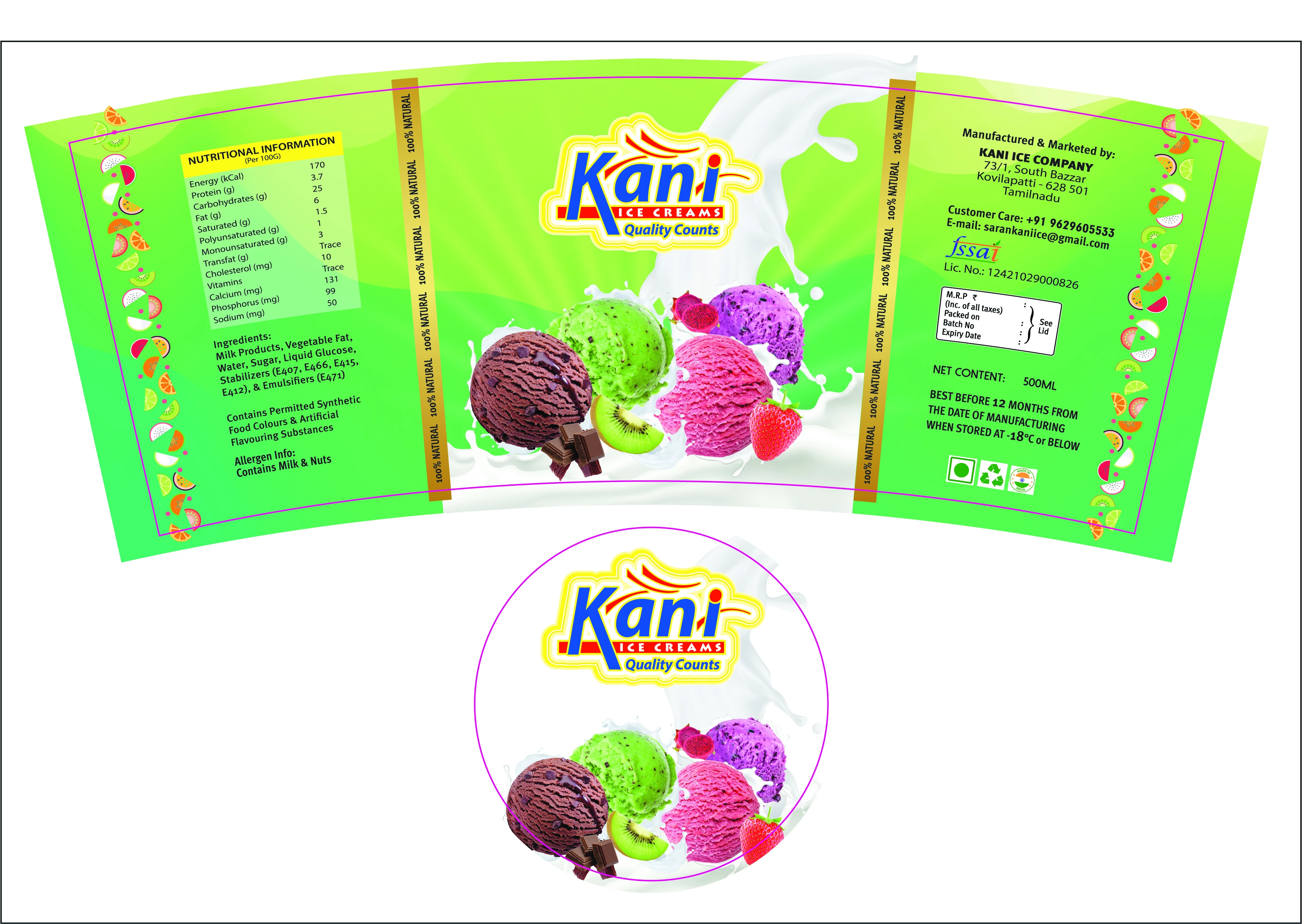

Thank you very much for your reply. Last question regarding the keyline. So the final file for production will only be the adjusted artwork without showing the bleed or template outline because it's masked, right? Btw, the client cancel this project, but I'm asking just for the knowledge sake
I will explain the work flow for you and the entire community users.
We assume that a manufacturing / packing company is about to launch a new product. This product requires an attractive packaging. The company finds a designer and a printer to achieve this. The printer will ask for a physical sample of the product or a 3D design file. Then he will export a UV Texture from the design or he will create a 3D design himself to work with. This UV Texture is then converted to a Keyline and will be sent to the designer. Second image is an example.
Now the designer will create an artwork and adjust it with keyline. In the example keyline, the blue line is maximum boundary for the artwork. The pink line is the cutting line ( Die cutting / Laser cutting). Dotted pink line is the text boundary (The important stuff including the logo, text and legal information should not exceed the dotted line). Space between the blue line and dotted line is the "margin of error" for the printer. If the important stuff exceeds the dotted line, it might be cropped out. When the designer sends the artwork to the printer, he will mask the entire  curved artwork upto the blue line and will put the die line on top of the artwork. First image is an example (It is a 500ml conical shaped plastic container for ice cream, IML - In Mould Labeling is the process).
Printer will print the entire artwork up to the bluline and at the time of cutting he will follow the die line. Normally the artwork is printed on to a white substrate (Base material / plastic film). Depending on the accuracy of the cutting machine the die line will slightly vary, thats why we give him enough space to play with. If the artwork is not exceeded upto the blue line, and the cutting line varies, the white substrate will be visible on final output.
See the linked video to see the final output after IML moulding ( Process - Injection moulding with robotic IML)

Vishnu Thilakan
March 22, 2021

If you state the measures of the present flat art including the label boundary along with the cone shape properties (angle between left and right side and distance from the tip (apex/vertex) of the conical shape (in most cases outside (the relevant part of) the container which is normally a truncated cone) up to the bottom or down to the top (depending on the direction of the cone (icecream or bottleneck)), I believe I can give you the directions to get the right undistortion. Instead of the distance from the tip you can also state the width/circumference at the top and bottom of the (relevant part of) the shape along with the height.
Vishnu Thilakan
March 19, 2021
Sir,
A new pdf is attached for your reference. The keyline drawing is exported from Autodesk Powershape which is used to create the 3d  container model for machining. The attached drawing is in relative proportion. I have marked the details that I understood from your reply.
