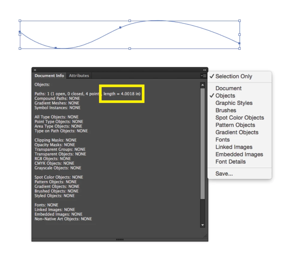

May 27, 2015 10:29 AM UTC
Length of path.
Select the path.
Window > Document Information > -drop down menu- Object

sharp_hands16B8
Jun 2, 2016 9:46 PM UTC
Yup, this is the best way mentioned by Mystiq.
Here's a screen grab.
