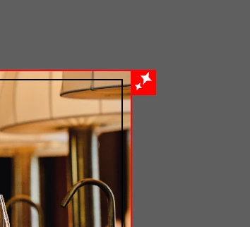

Olá, procurei e não consegui achar opção de ocultar o ícone de conteúdo generativo na opção de "Sangria para Impressão" na última atualização 29.6 (16/06). Alguém sabe onde posso encontrar?
Trabalho com opção se sangria sempre ativa e achei o ícone vermelho muito chamativo, interfere demais na visualização das composições, principalmente quando existe a necessidade de visualização de cores mais precisas.

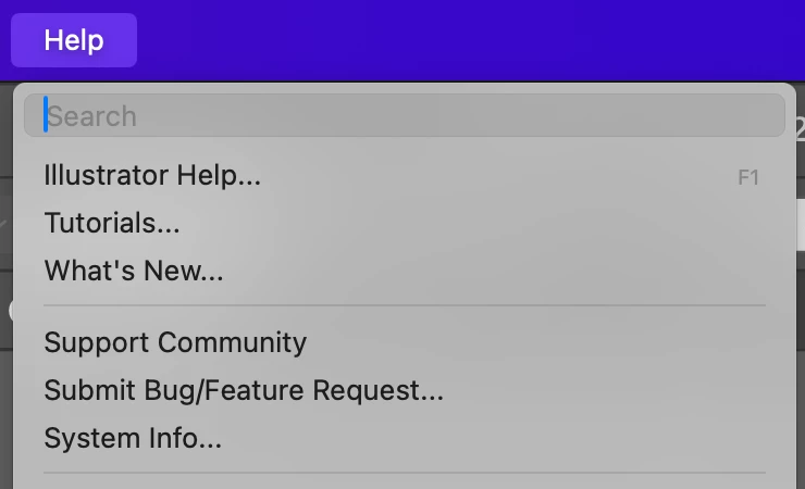

June 20, 2025
Submit this as feature request:
Help - > submit but / feature request

How do I remove this giant red box that appears and scales when I zoom out? It looks like an Adobe ad for AI bleed generation and it's cluttering my screen. I don’t have any credits, and I’m not interested in purchasing any AI generation features. Just want it gone — thanks.

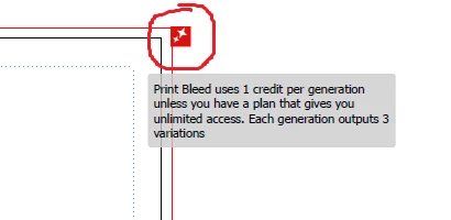

June 19, 2025
Hello @phatdanz4,
Currently, it is not possible to turn off this feature in Illustrator. Our team is aware of this and is currently working to fix this with a future release. In the meantime, kindly upvote this UserVoice (https://adobe.ly/4ekWNWz) and add your comments there. That way the product team will be able to better prioritize this, and you will be notified of any updates.
Feel free to reach out if your have more questions or need assistance. We'd be happy to help.

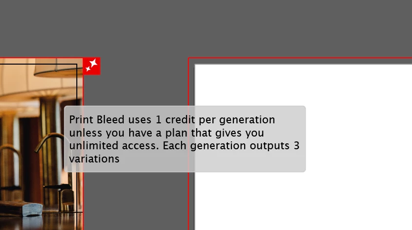

June 19, 2025
What the heck is the new message with three stars on the Bleed Line: Print bleed uses 1 credit per generation unless you have a plan that gives you unlimited access. Each generation outputs 3 variations." ?????????????? Personally I find this extremely annoying because I do not use AI features very often.

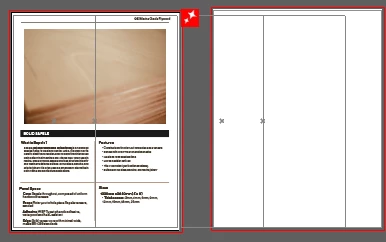

June 19, 2025
Since the last update I notice a big unwanted info block in the Artboard panel about 'trying generative', it occupies almost the half of my panel, very annoying.
Any way to disable that?
