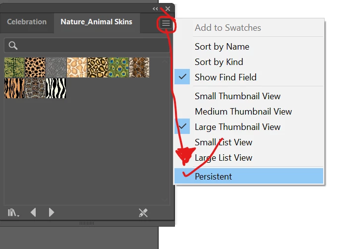

Mike_Gondek10189183
June 13, 2022
Create a swatch library
You create a swatch library by saving the current document as a swatch library.
  • Edit the swatches in the Swatches panel so that it contains only the swatches you want in the swatch library.
Select Save Swatch Library from the Swatches panel menu (Choose a nice name to keep yourself organized as you will see this)
Then in the flyout menu for your new library check persistent. I would take the extra step of saving a workspace, as the persistent has been buggy in the past.

Mike_Gondek10189183
June 13, 2022
Yes it  wil be added to a new swatch panel name you choose as seen in my screenshot (eg: nature Animal Skins).
To add to your swatches you would have to use the method Doug suggest. With that though will only work n new files that are crated using the document profile() you edited, not existing documents.
