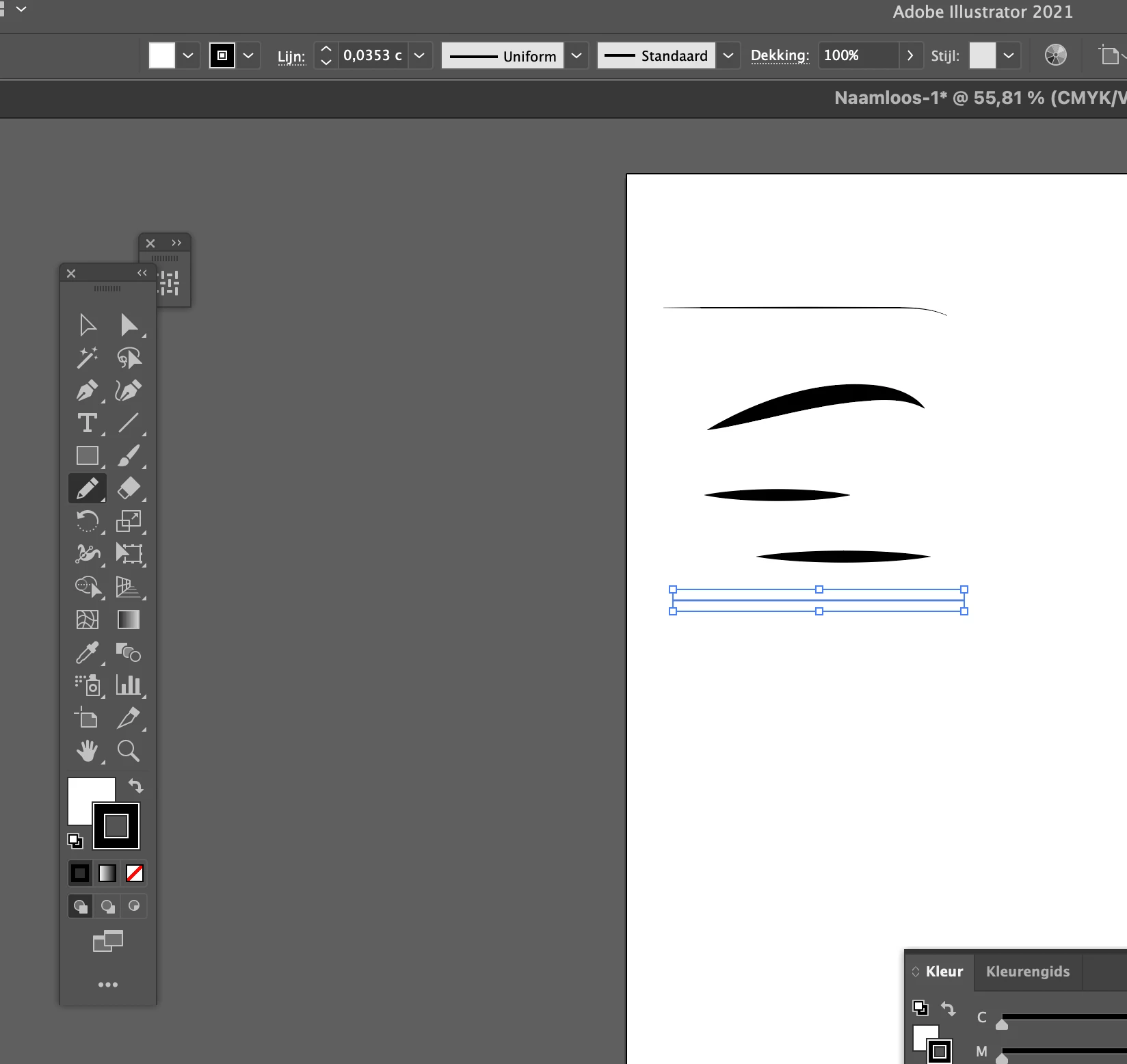

If I change the settings of my pencil tool and start drawing it automatically goes back to the standard settings, I have looked everywhere but can't get it solved, same with the brush tool. Already installed Adobe illustrator again, but the problem is still there. I only can change it when the line is selected and I add the thickness and appearance again, but that is not workable. Who knows how to solve this problem?

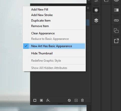

    In the menu for the Appearance panel, is 'New Art has Basic Appearance' checked?
    pR!nce_m@z
    April 25, 2024
    Uncheck this from the "Appearance" menu.
    Doug A Roberts
    Doug A RobertsCommunity ExpertCorrect answer
    December 21, 2021
