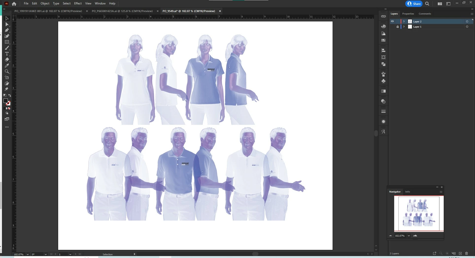

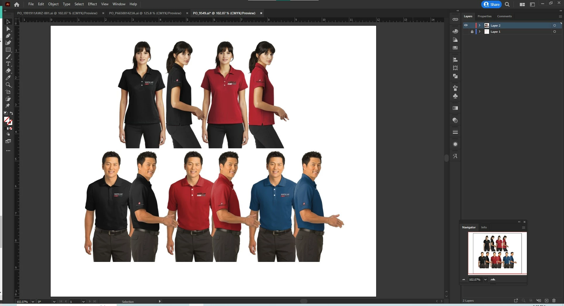

This just started this week. When I drag in or import a PNG image into my Illustrator artboard, it looks fine. Color looks good and is shown how it is supposed to be.
However, when I save and close out the window then open the project back up, all of the PNG images now have inverted colors. I hadn't changed any type of setting.

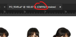

You in a print mode of CMYK and placing png images that are meant for a digital RGB workflow?
File >> Document Color Mode >> RGB or use .PSD CMYK format if doing CMYK print workflow.

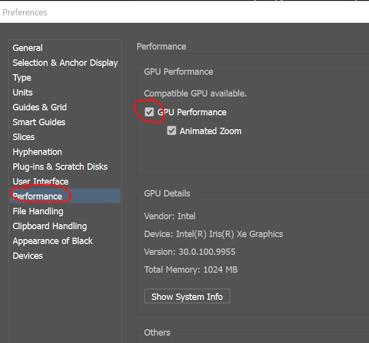

Sounds like a redraw issue with recent upgrade. Try unchecking GPU performance
May 31, 2022 5:50 PM UTC
Niether changing the color mode to RGB or unchecking the GPU worked.

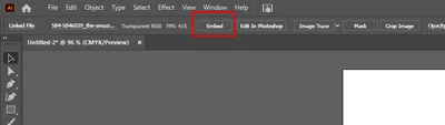

Did you try to Place the png instead of open?
