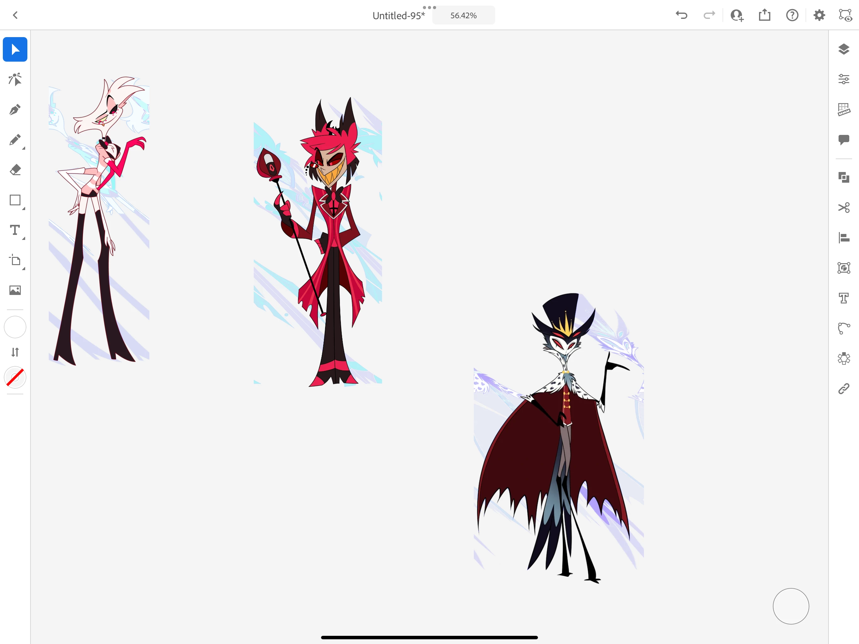

I''m having an issue similar to that of yours, only IT LOOKS LIKE THIS! Is there a solution to this situation???

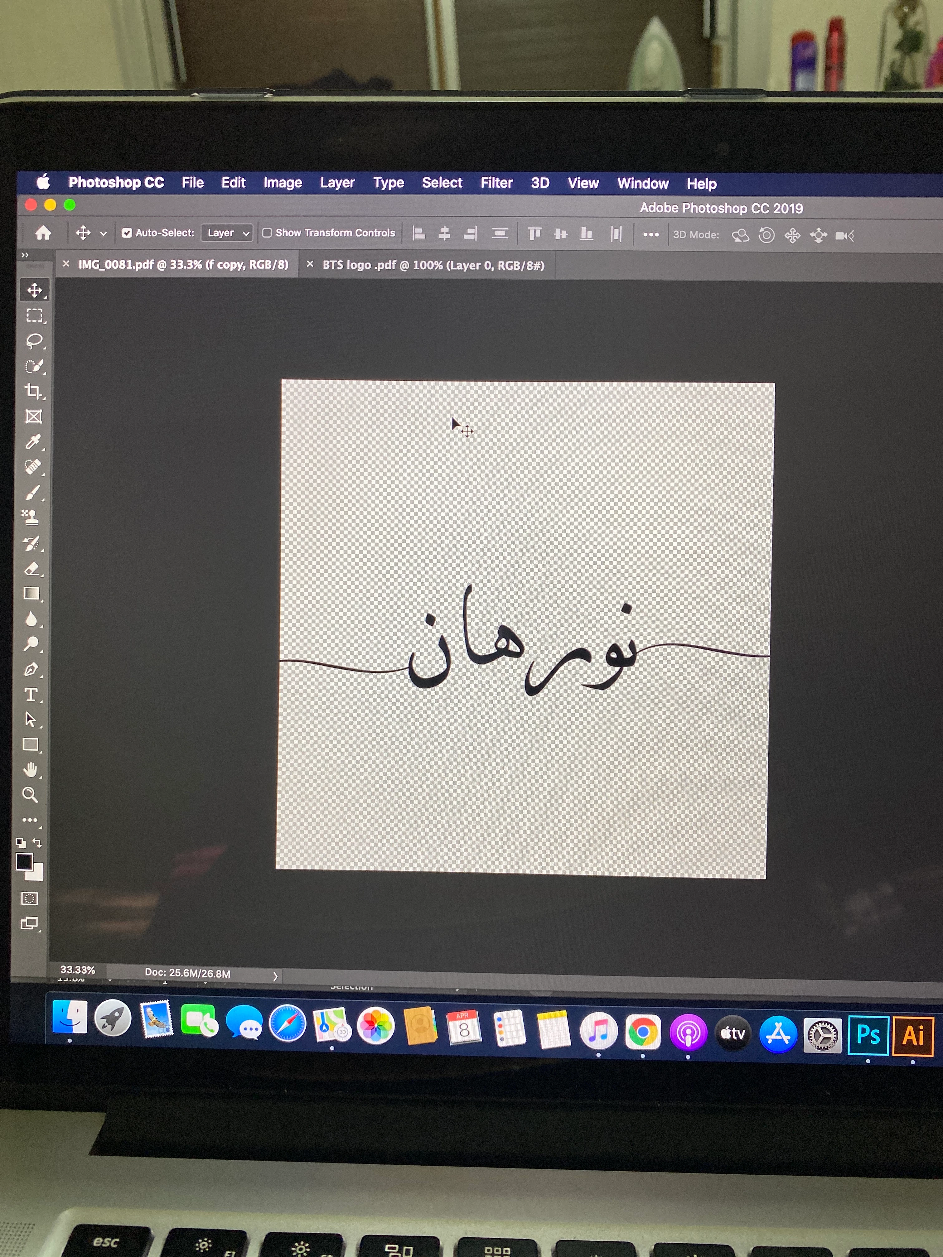

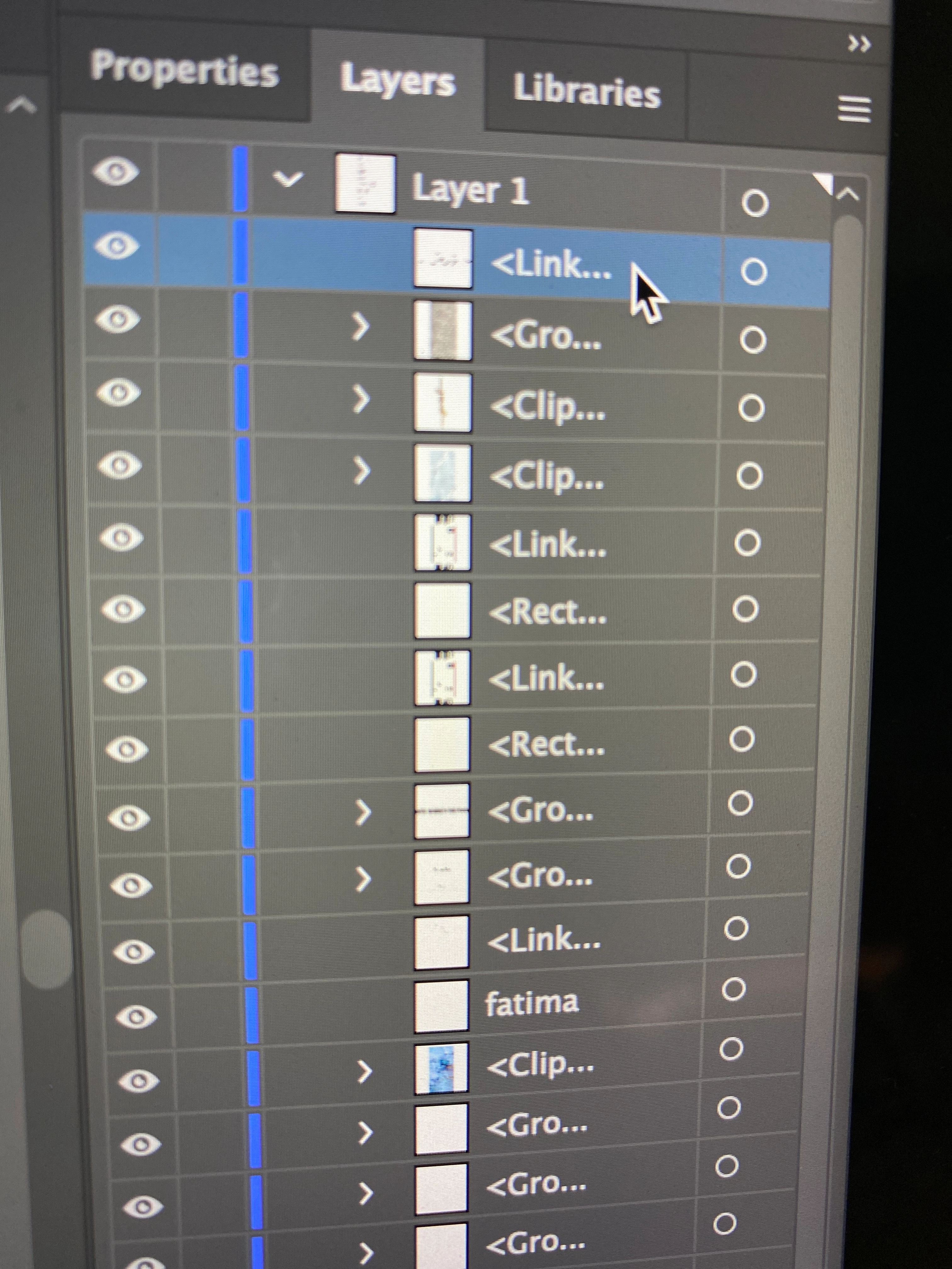

Apr 8, 2021 4:52 AM UTC
I am having the same problem of when i save an image on photoshop as pdf or png ( i want the background to be transparent) and i use it on illustrator , it's showing the illustrator color as its background.
also , the layer is names as linked....
it used to be named by the name that i gave the file.
every file that i've imported to the illustrator is being read as <linked file>
please help
Ton Frederiks
Apr 8, 2021 6:33 AM UTC
Did you turn on View > Show Transparency Grid?
The names of Linked files can be seen in the Links panel.
