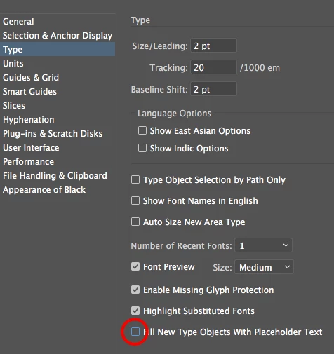

    Hi Anthony,
    I do not remember ever being able to click and drag outside a text container without that creating a  new text container.
    But try turning this off just incase that helps.
