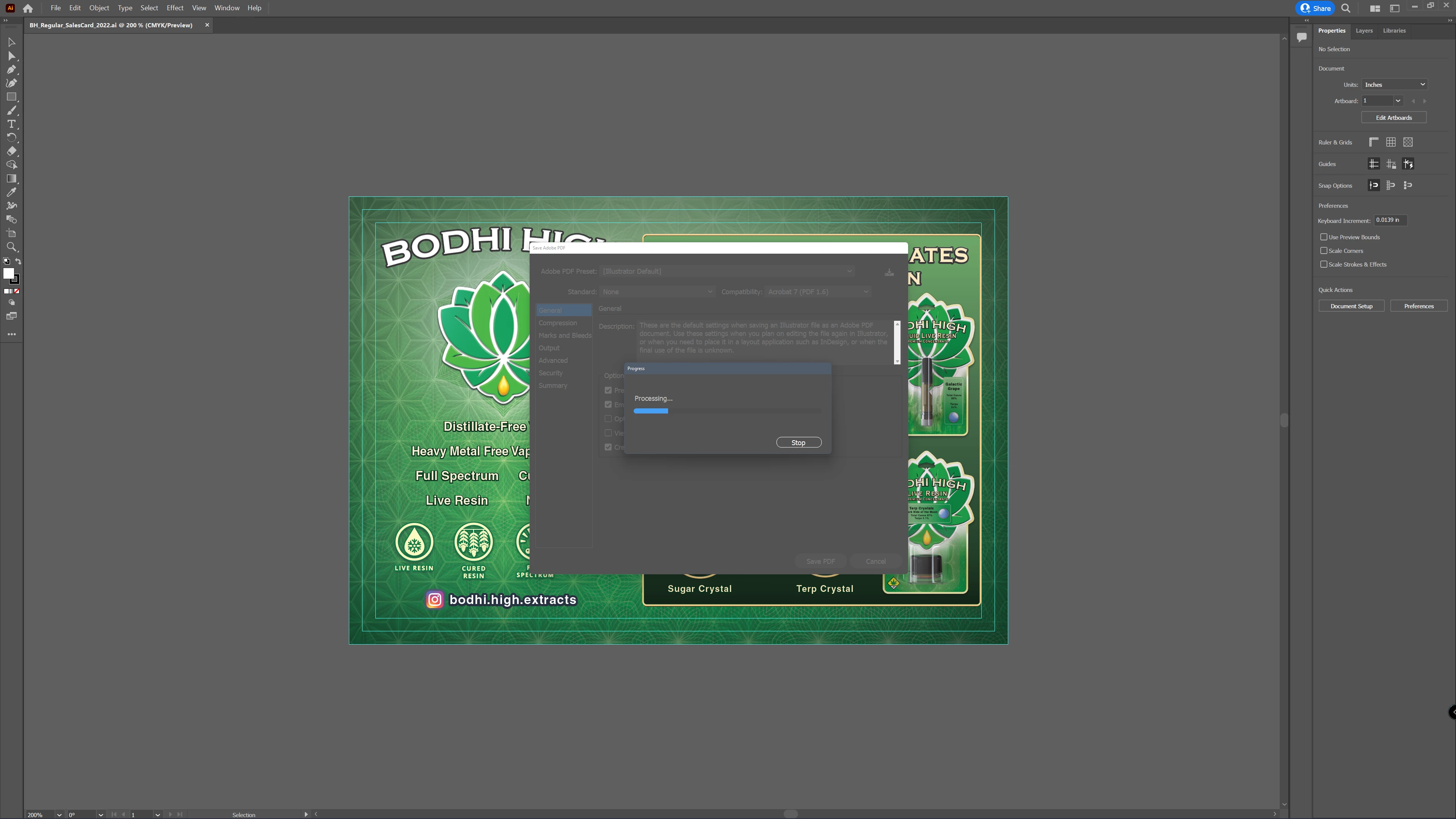

BroadstreetStudios
Aug 9, 2022 2:42 AM UTC
Same issue here, cannot save client files to export (PDF) format for delivery without this occurring.  Screenshot attached.
Latest version of Illustrator (26.4.1) and Windows 11 21H2 (build 22000.795)
MrBill812
Aug 9, 2022 2:59 AM UTC
Roll back to the previous version of 26.3.1 & you should be O.K.
Aug 9, 2022 3:04 AM UTC
Interesting, the older version I've reverted back to is 26.4. I assume the lastest was 26.4.1? What ever it was it wouldn't work, all good now.
