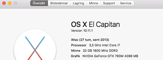

    November 5, 2015
    Hey guys!
    I have the exakt same problem started this morning after I installed El Capitan.
    I'm using one additional monitor which is connected to my iMac, and I can't right click inside Illustrator while its connected.. This is an big issue!
    This is my OS:
