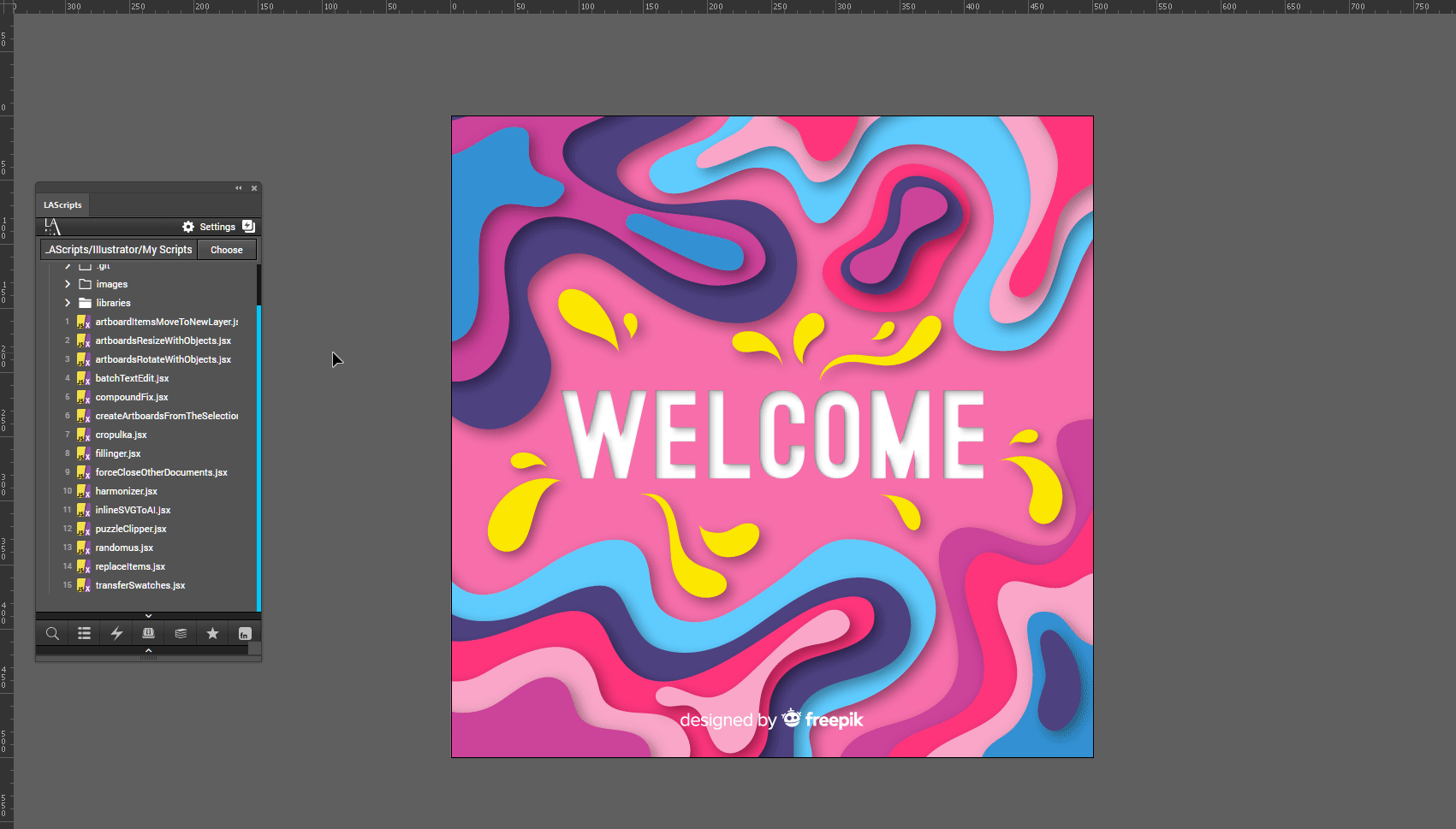

Hello community,
Looking for illustrator script to rotate artboard with artwork 180 degrees.
please help
Correct answer Sergey Osokin
I added the 180 degree option. I'm waiting for Alexander to post an update on his GitHub. You can check the update at my link for now https://gist.github.com/creold/5e50f51267d04cdb540479ae3e13c33b

Alexander Ladygin also had a script for 90 degree rotation of artboards with artwork. You can change the degrees in the code https://github.com/alexander-ladygin/illustrator-scripts#artboardsrotatewithobjects
MidoSemsem
July 1, 2022
@Sergey Osokin  Excellent one, I use it all the time. But I don't know how to add 180 degrees to the code and the dialogUI.
