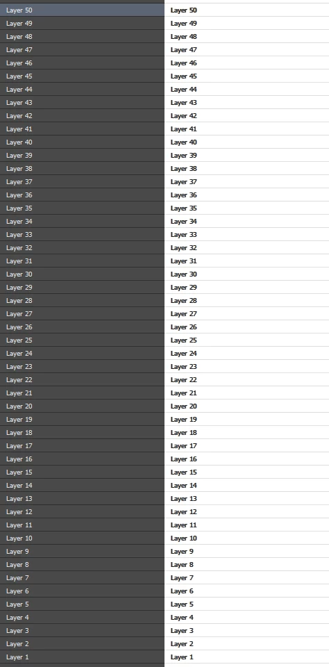

I wonder if someone could help me to make simple script wich take layer's names and making list from them on A4 canvas.
Now i just doing screenshot of illustrator list and modifying it via photoshop to print, but it is too small, because each ai file has about 25 - 50 layers.
Looks like that:
