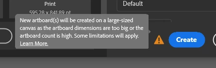

    I had the same problem as this one, and the problem I experienced was that the canvas resolution was too big.
    At that time I wrongly set the canvas size which was originally 1920 cm x 1080 cm, then a warning symbol appeared next to the "create" button (this symbol appears, because the canvas size is too large so some functions will be interrupted later). After I changed the unit to pixels the software worked as usual moment.
    I hope this helps 😄
