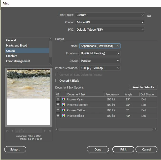

February 21, 2017
Hi there,
Are you using the "Separations" mode during printing, as shown below?
Om
February 22, 2017
