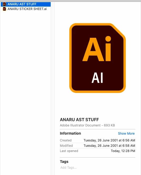

Hi, I'm unable to open some important old vector files that I have dating back to around 2001. They would have been generated in Freehand but are showing with an Illustrator Icon. I've tried adding the .ai suffix but that hasn't helped. I've also tried File > Open without any luck either. No joy with any other adobe cc programs either. Does anyone have a fix for this ?   Thanks

I found a similar post where Ton recommended a script to convert them:
Monika Gause
January 7, 2023
It will work only in the context of that answer: on a machine running CS5
