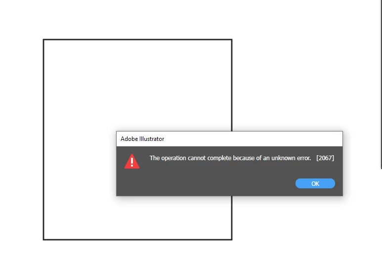

I am experiencing the error 2067 when trying to EXPORT a file from illustrator. I imported an svg, and tried to convert to dxf and it failed. So i tried with just a square nothing else, and it still fails.  So I'm certain this isnt an issue with importing an improper file. thoughts?

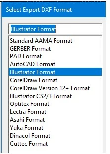

Hi, the same applies to me. A .dxf file, probably created through the PTC Creo Parametric application, opens fine in AI, can be edited and saved as .ai and .png, but 2067 appears when trying to export to .dxf. BUT, it only appears when I try to export to the legacy name. So it was easily fixed in my case. (Yet to be seen if the result can be read properly in CAD.)
