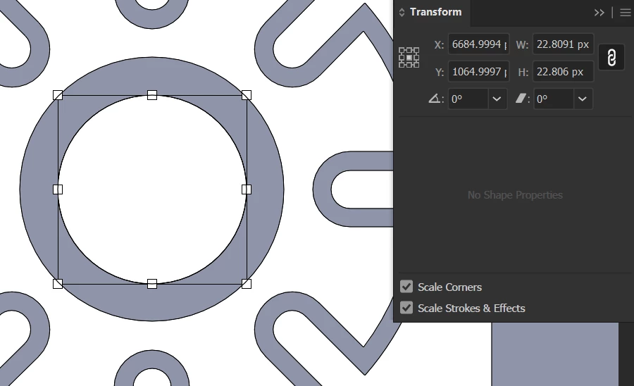

Well, for me this is a major problem cause I create manuals for other people to reproduce things and I cannot put "even though that circle shows as 29.999 x 29.888 you must create it 30 x 30"
Take a look at the image below for example, I have scaled down a compound shape and what was a simple circle in the middle is no longer centered or even:
April 22, 2023
It is still centred and even for all practical purposes, even if there is a difference at the 7th significant figure. If you feel this is a concern for your people, because they too worry about false precision (reference: https://en.wikipedia.org/wiki/False_precision) you can say. "The size is 30 x 30. Because Illustrator shows so many decimal places, this could show as anything between 29.998 and 30.002 - do not be concerned that this will affect the output."
