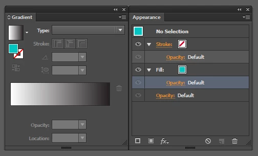

davidm20114112
Nov 22, 2018 10:10 AM UTC
I found that one thing stopping layered psd exports was strokes with gradients across the stroke applied. Once I took this off then it exported the layered psd no problem.

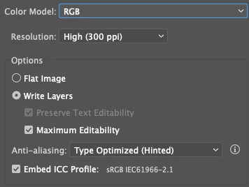

Jan 11, 2022 8:26 PM UTC
Appears to be an Adobe issue, at least they told me they would look into it because they were able to replicate the problem.  I reported a few months ago in 2021.  I suspect its mostly AI....especially if you get the message below where PRESERVE TEXT EDITABILITY is grayed out....usually is a sign its not going to retain the layers and will flatten.  And it doesnt seem to matter if Type Optimized or Art Optimized is selected in Anti-aliasing

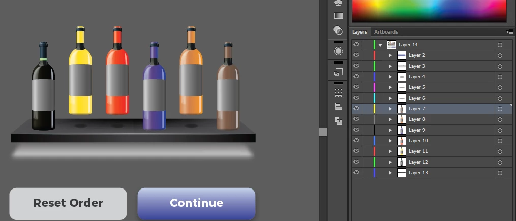

Sep 15, 2017 1:06 PM UTC
Hi everyone, i tried to export PSD from illustrator with different ways and these different methods are surly work for you.
(Method 3rd work for me with this attached preview file.)

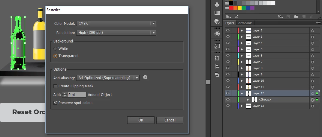

METHOD 3:
Select the object from the layer panel and go to Object > Resterize.. and follow the below instruction (user this method for all those objects which are not converted layers) and then Export > Select type PSD and save. Now open this PSD file to Photoshop and Boom! you just converted your AI file to PSD with layers.
I wish this will help for you! Cheers Designers!

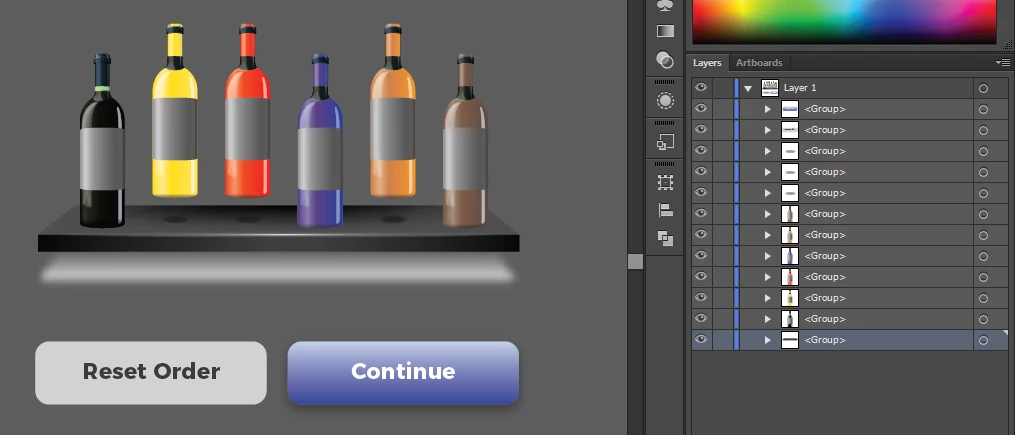

chrisc18905858
Jan 12, 2017 12:20 AM UTC
I am having the same problem right now with CC 2015.5 I checked and none of my layers have any transparency, gradients etc. I removed layers that could cause problems just shapes and flat colors. Still flattens the file. I tried the crop marks trick worked on another file but not this one.
The screen shot is from my top layer in the file.

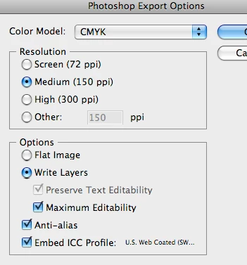

Apr 22, 2011 6:46 PM UTC
Did you choose cmyk as the color model, the option for write layers is greyed out on rgb files?
