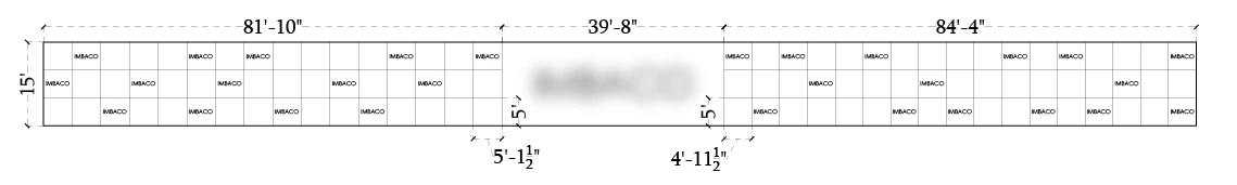

Apr 22, 2018 8:39 PM UTC
There are a Huge PROBLEMS if Working with Scale as listed below:
1) If used Raster Image, Calculate its Resolution (Proportional to its Physical Position)
2) If used Repeatable Pattern on Background, and when i am Fully Satisfied with the Pattern Size, i will Sent it for Printer RIP and he will Simply SCALE UP the Pattern 10 TIMES! If i could design at 1:1, i would rather Repeat pattern instead of Scaling.
3) The Allowed Maximum Size is TOO SMALL that we cannot even Design at Scaled Ratio of 1:10 and 1:12, which is usually Required by Printers and Easy to Calculate. Myself I need to Design a Banner which is 206 Feet Wide. Can't Design it in 1:10 (Bigger than 227 inches), neither in 1:12 (bigger than 200 inches which is a BOTTLE NECK by PDF)!
SUGGESTION:
Remove the Export Limit from illustrator to PDF (which is currently set to 200 Inches!), We want to Send Print Ready PDF file which don't need further scaling.
If you can't Remove the Limit entirely, at least Extend it so that Most of the Time we would work on 1:1 and for Exceptional Case, we would be able to work on 1:10 or 1:12.
