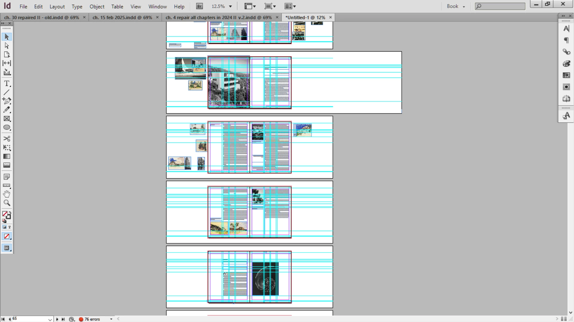

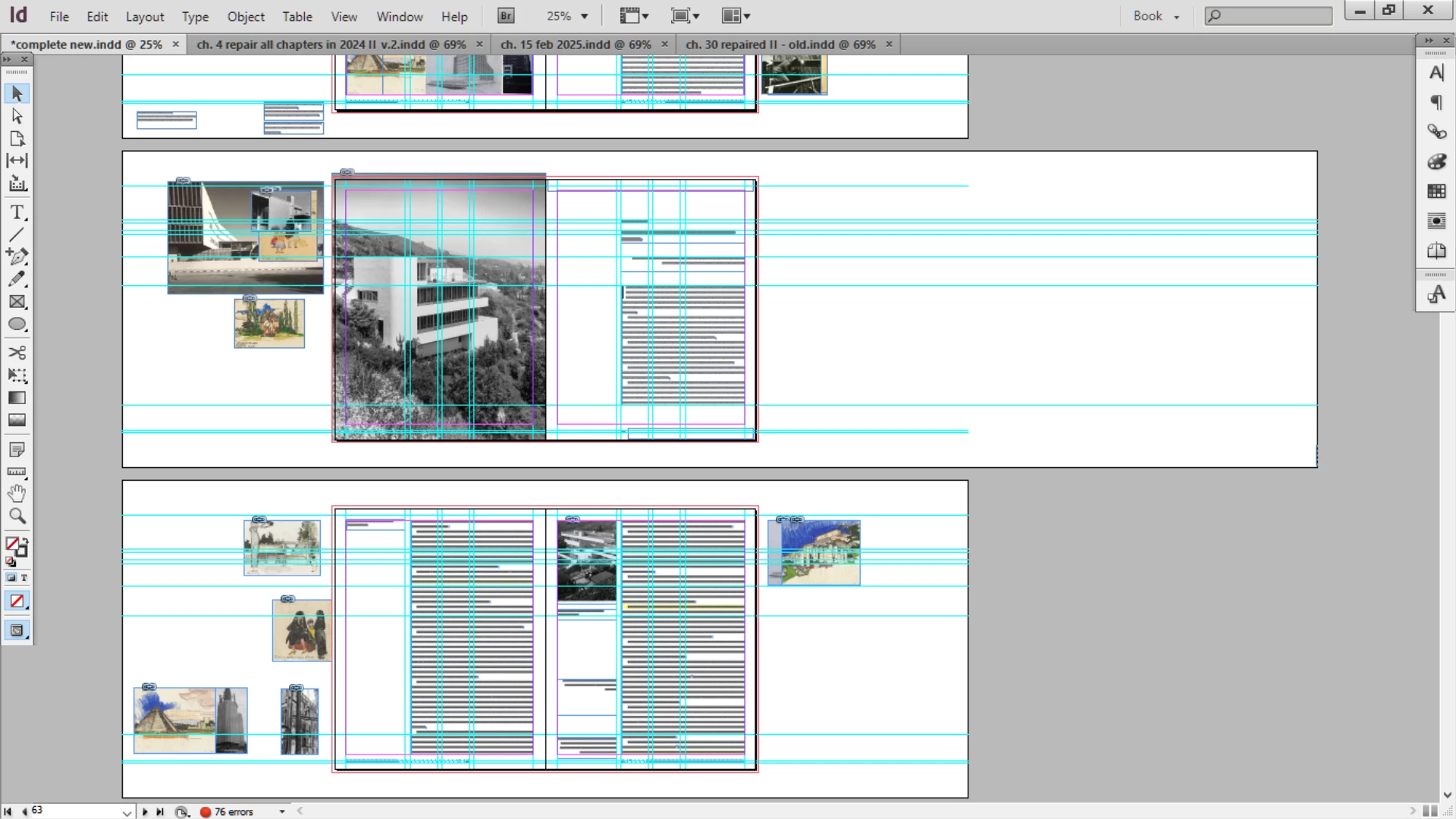

It's been a while since this happened – a month – but now having the pasteboard on 1 page of ~400 suddenly extend out one side. I immediately stopped work and IDML'd it. It did not change. Now will delete this one page and replace/reconstruct the page, and perhaps avoid using the pasteboard for idea collection going forward. But this is bizarre and problematic.

Thanks for mentioning - but you don't need IDT for that.
Just go to this spread, hit Ctrl+A - Select All - your selection will extend to the far right - where there will be a single point selected - press Shift and do area selection of everything else on the spread - only this one point on the right should be left selected - press Delete key.

In Preferences, you can set your own extra space around the Pages on the Spread.
But if there are objects outside this space - InDesign automatically extends it.
Can you share this one Spread with this bug? You can remove everything else on the spread - just so this one object remains.
