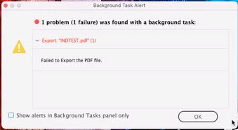

It is working fine on the location machine, . It is just not working when opened from SMB shares (working of from MacOS Big Sur 11.x), few more issues that we are having -
Once you open indesign file (from the network SMB share)- the log file ("idlk" ) and TestFile will be generated before even closing it.
(Please note: Opening the files from windows machine from the same network SMB share it works just fine)
P.S :
- we tried the other options from the KB which did not work.
-we have enlarged that error screenshot attached - doesnt give much info. It just says
Background Task Alert
1 problem (1 failure) was found with a background task
Export "INDTEST.pdf" (1)
Failed to export the PDF file

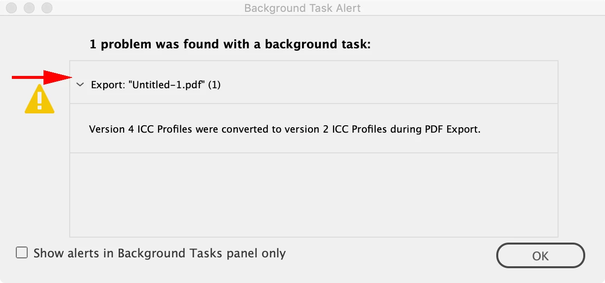

Hi @Binny25572692twmf , what’s the listed error? Toggle the arrow in order to get the details.
