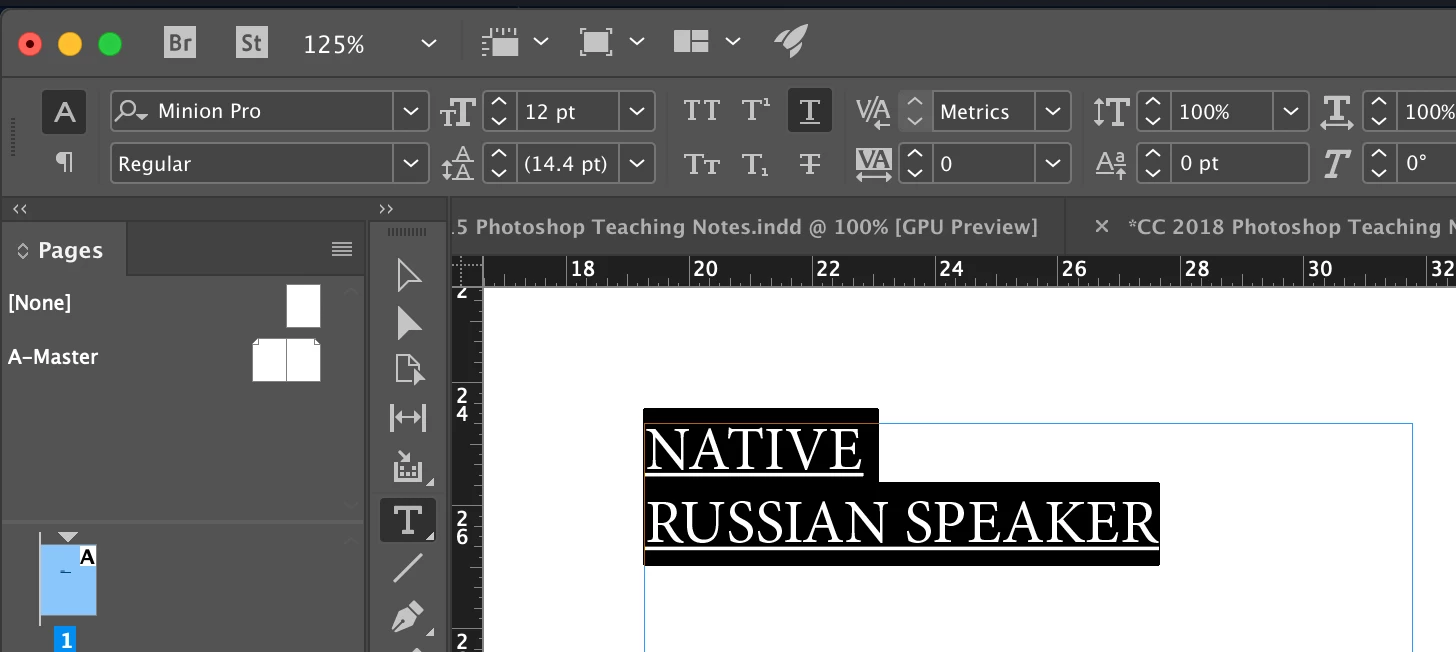

Hi guys,
I searched under Text and Typography, however still can’t find what I need. How do I create a background in colour behind the text that is of the same shape as a text?
Like it‘s written TEXT in white on a black background?
PS I have a screenshot but cant really attacg it here.
Thanks!

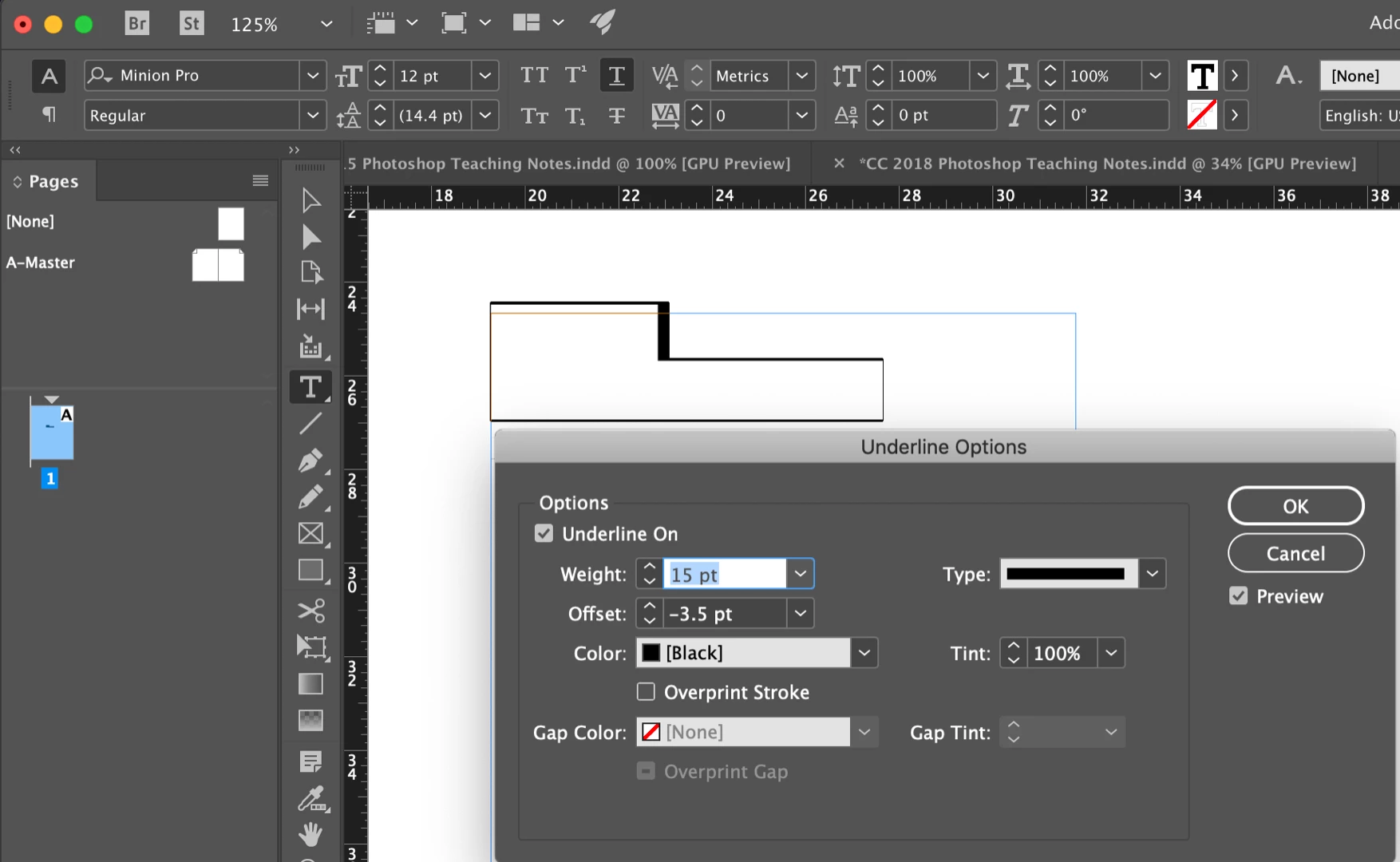

    Hi Elena:
    I think Jeffrey's approach is a good one. Here are the visuals to support his answer.
    1. Type in the text and turn on underline.
    2. Alt/Opt click the underline button to access Underline Options. Increase the weight, adjust the offset and change the color to Black.
    3. Change the text color to Paper/White.
    4. Now when you change the text, the background changes with you.
    5. Save this as a  style and you can apply it to any text.
    ~Barb

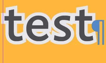

    How about giving the text a stroke of whatever thickness and color?

    Barb Binder
    Barb BinderCommunity ExpertCorrect answer
    October 23, 2018
    Hi Elena:
    ~Barb

    Hi Elena,
    do you mean you want to define a stroke value to text with alignment outside?
    Perfectly doable with InDesign.
    For including screenshots use the Insert Image icon of the forum editor.
    You cannot attach images when answering replies by mail.

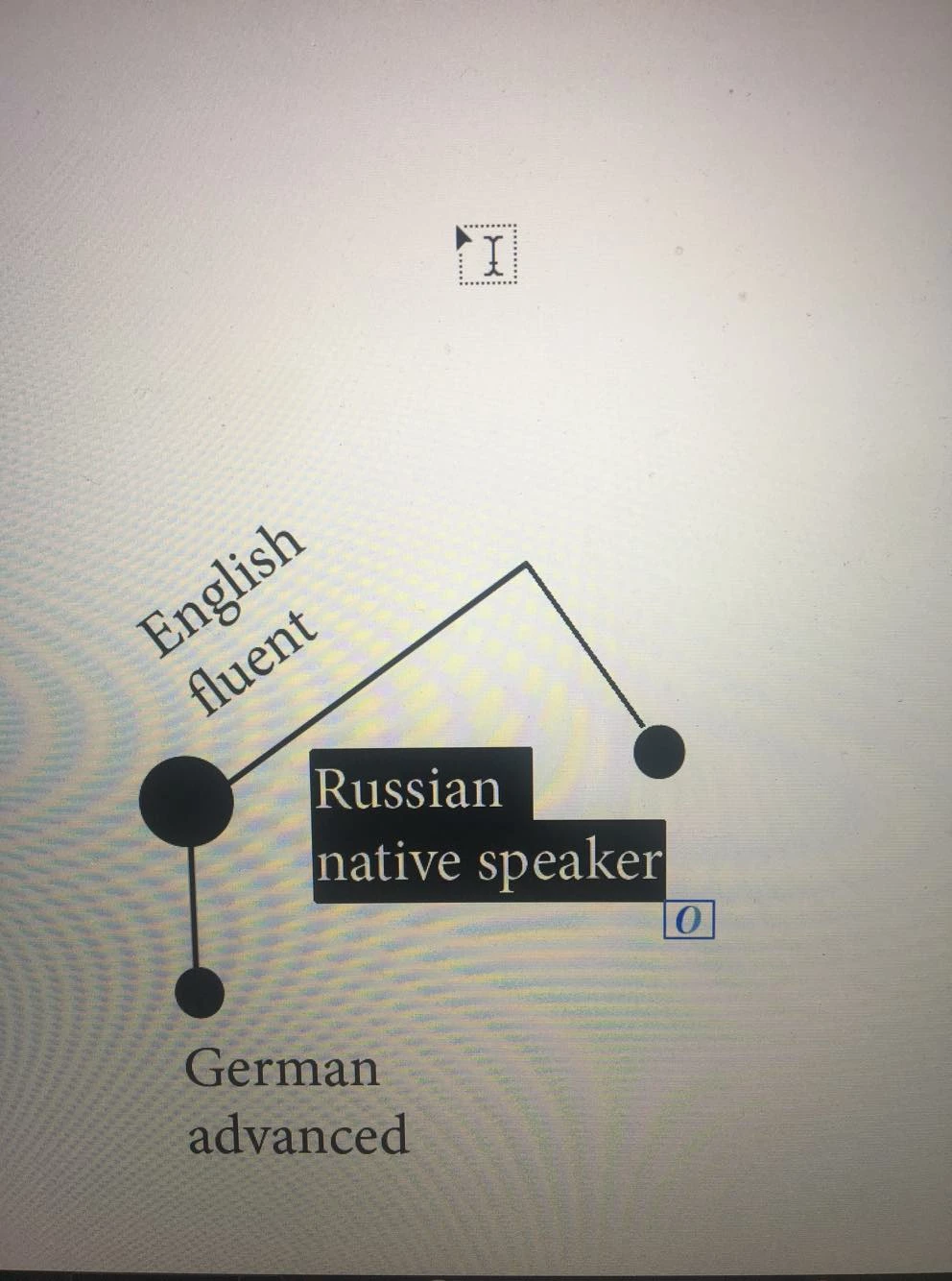

    So here is the screenshot. I am not really sure what is the correct word of this action but I would like to create this shape in black behind the text "Russian native speaker". As for now I just marked the text with cmd + A, certainly it will be gone once I unclick it.
    Thanks everyone.

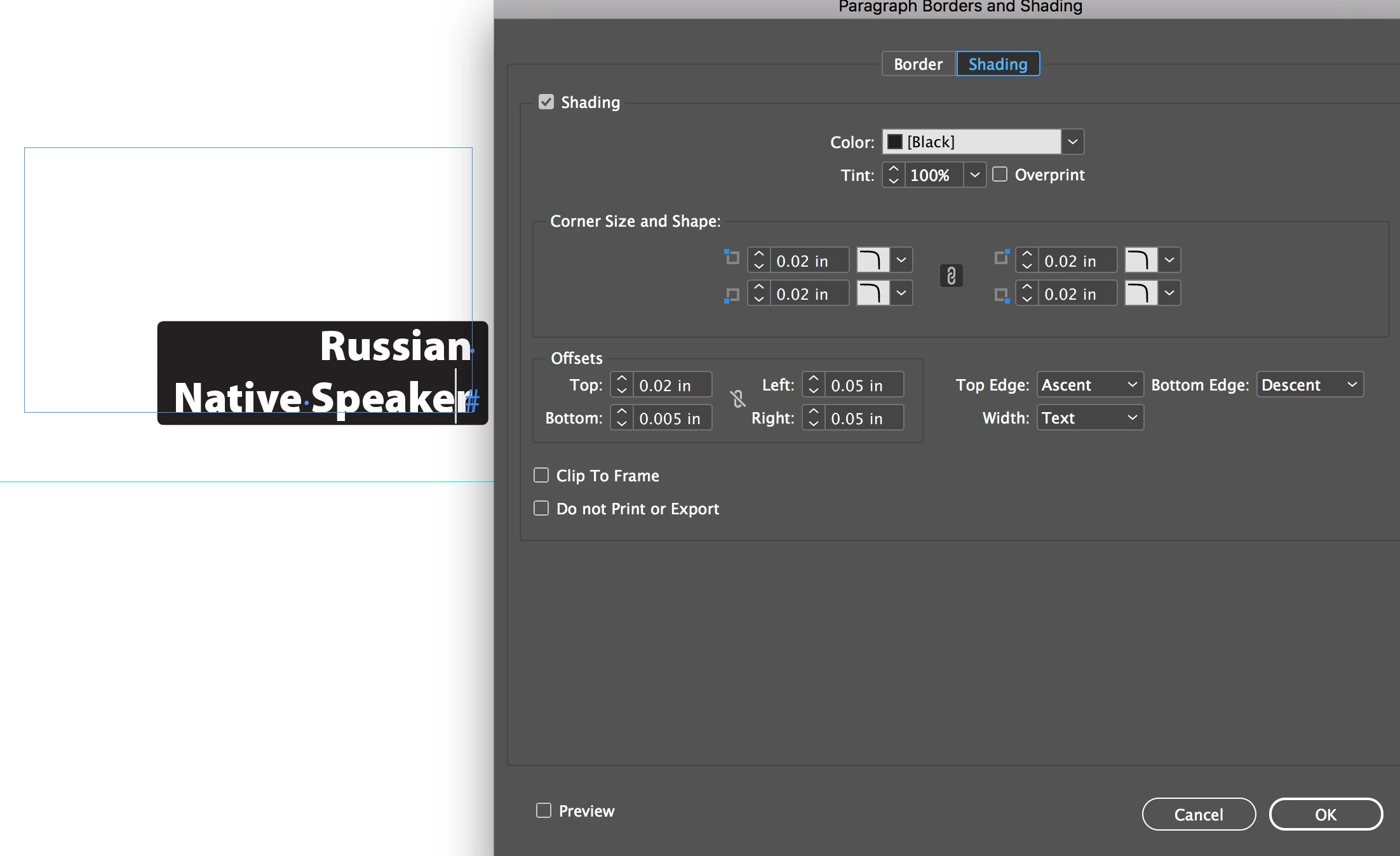

    If you have a new enough version, you can use paragraph shading:
    this will create a box rather than a rule like the underline.
    I might try to apply it as well. However, I do not really see the button? Should it be under Paragraph characteristics?
