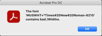

• When I open a newly exported PDF document, I am presented with the errof "The font... contains bad/ Widths."
I use inDesign to create PDFs and I don't use Times New Roman.

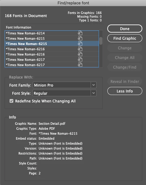

• I have recently discovered that my inDesign file contains 168 fonts, however, I am only using two. Roman is listed here, and seems to be the source of the problem.
• When I select 'Find Graphic' for the mysterious text, it takes me to a PDF file that I have featured in my indesign spread. It appears to identify the text within the document, and pick it up within indesign.
How can I stop indesign picking up text within embedded PDFs as font, but rather vectors? I am trying to avoid having to export each and every PDF in my large indesign document as JPG's to solve this small issue.

Hi Laubender,
Thank you. This worked - it turns out that one of the pdfs contained within inDesign had traces of Times New Roman, even though there was no text within the PDF. This wasn't obvious because it was a 2D drawing that I had scanned. Not sure how the text was detected.
Nonetheless, how I solved it using inDesign:
1. Type > Find/Replace Fonts > Select Times New Roman > Find Graphic > Right Click Graphic > Edit Original
2. In Adobe Acrobat:

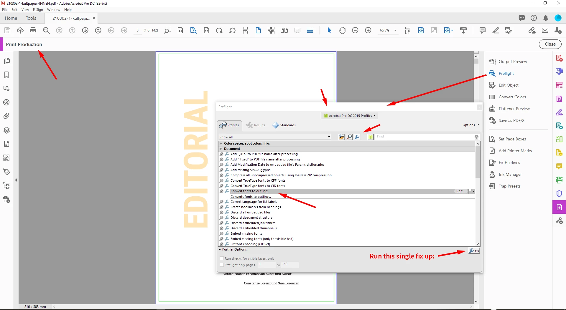

"How can I stop indesign picking up text within embedded PDFs as font, but rather vectors?"
Hi 11ccharris,
open the PDFs in Acrobat Pro and convert all text to outlines.
All details in this screenshot from Acrobat Pro:
If this does not work, you need to contact the makers of the PDFs.
