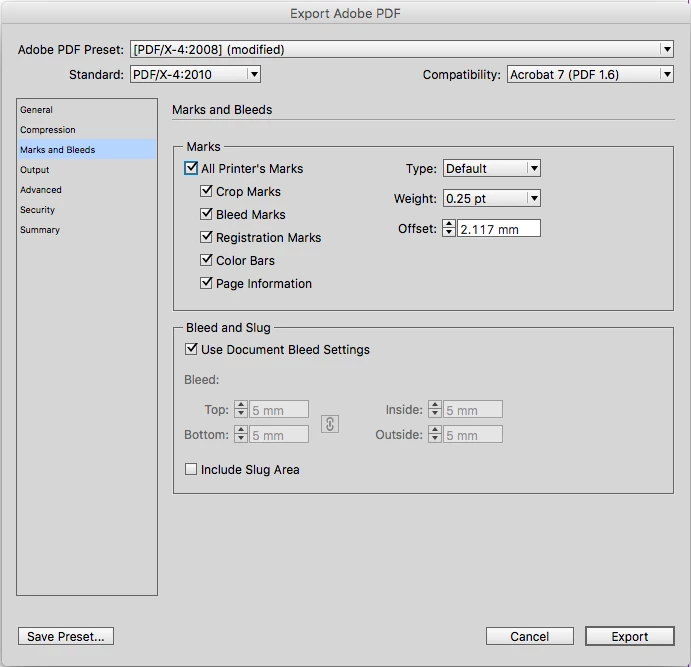

How can I settle on the same document two different full-bleed? I looked in "templates" but impossible to create a single full-bleed for each template. Any ideas ?
With facing page documents that require an inside bleed, the bleed is added from the export or print dialog:
The exported pages get an inside bleed if has been spec'd in the export dialog.

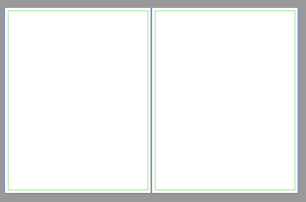

Here AcrobatPro showing spread view where the green line indicates the trim:
The only binding method that would require you to split the pages and manually add an inside bleed would be Wire-O where the pages's inside edges are trimmed and visible.
