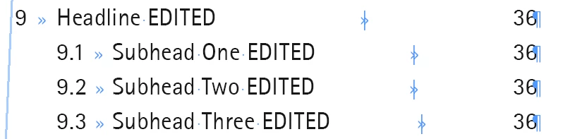

    TOC before update:
    After updating the TOC with InDesign CC 2018.1 ( no issues ):

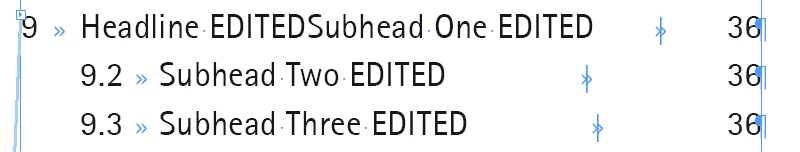

    After updating the TOC with InDesign CC 2019 versions 14.0.0.130 and 14.0.1.209 ( disaster ):
    Uwe
