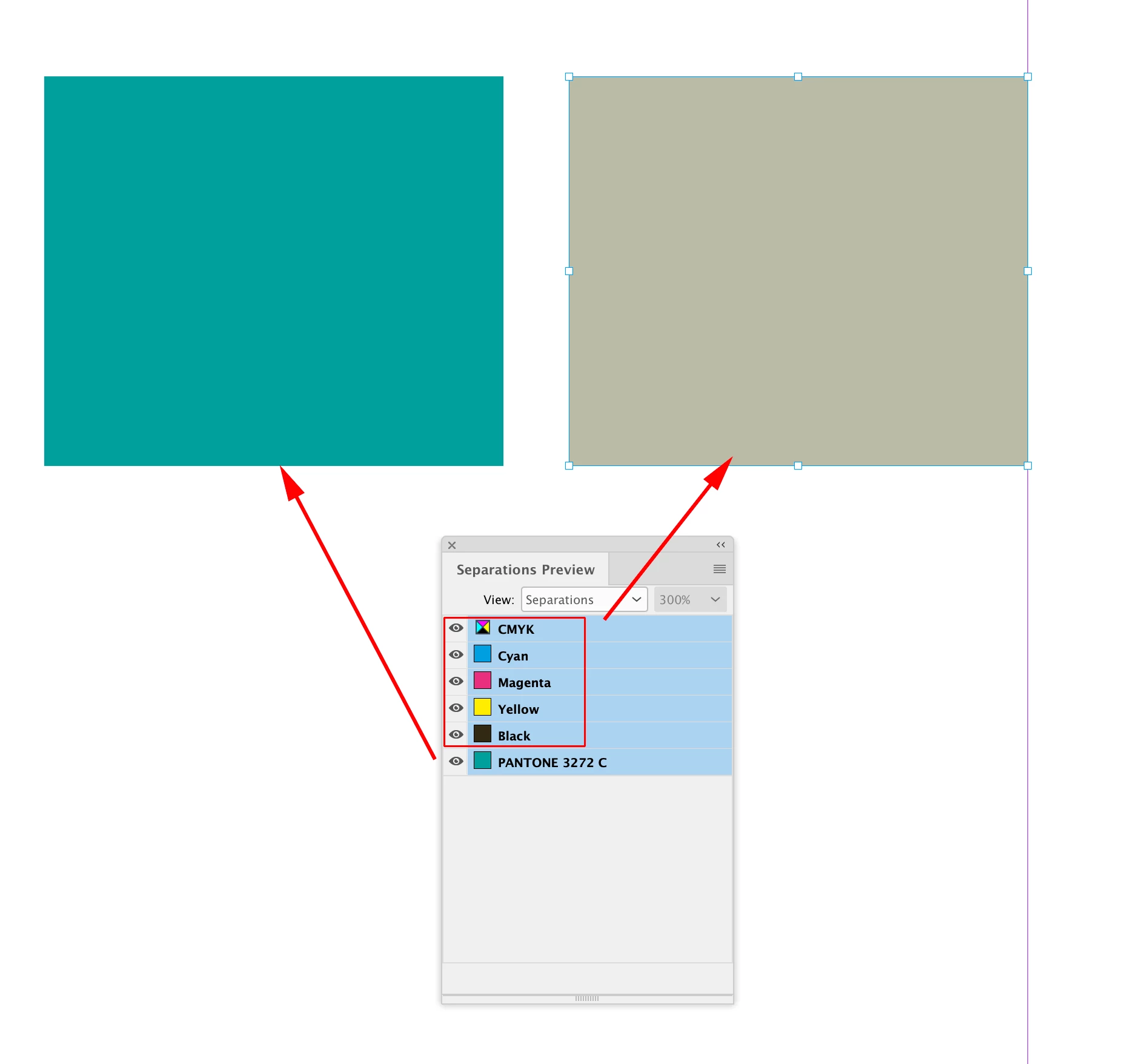

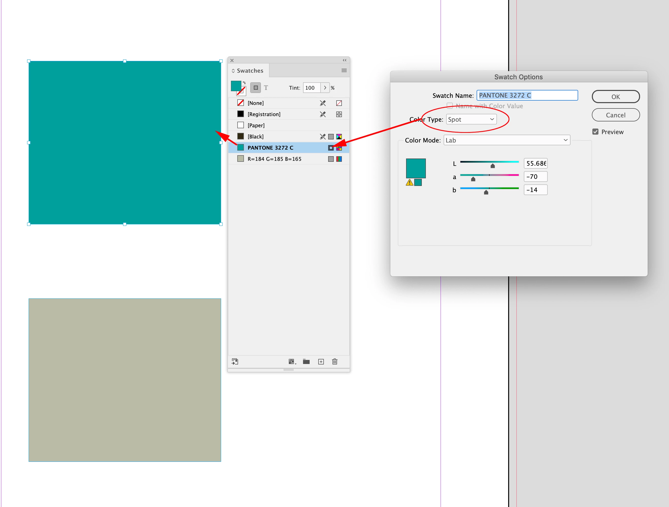

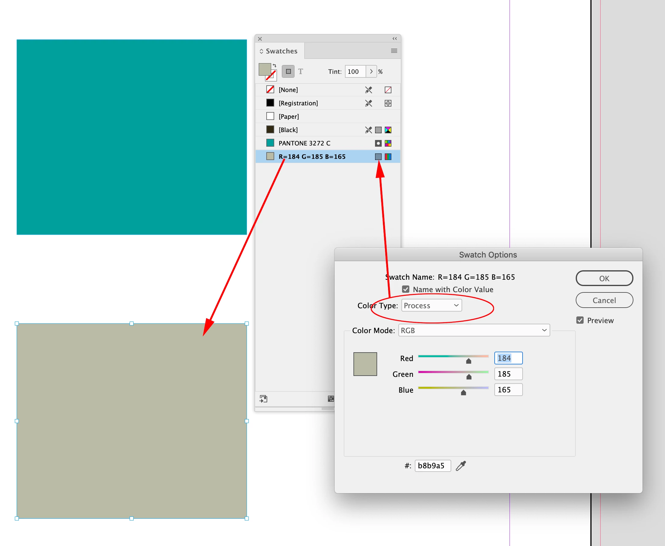

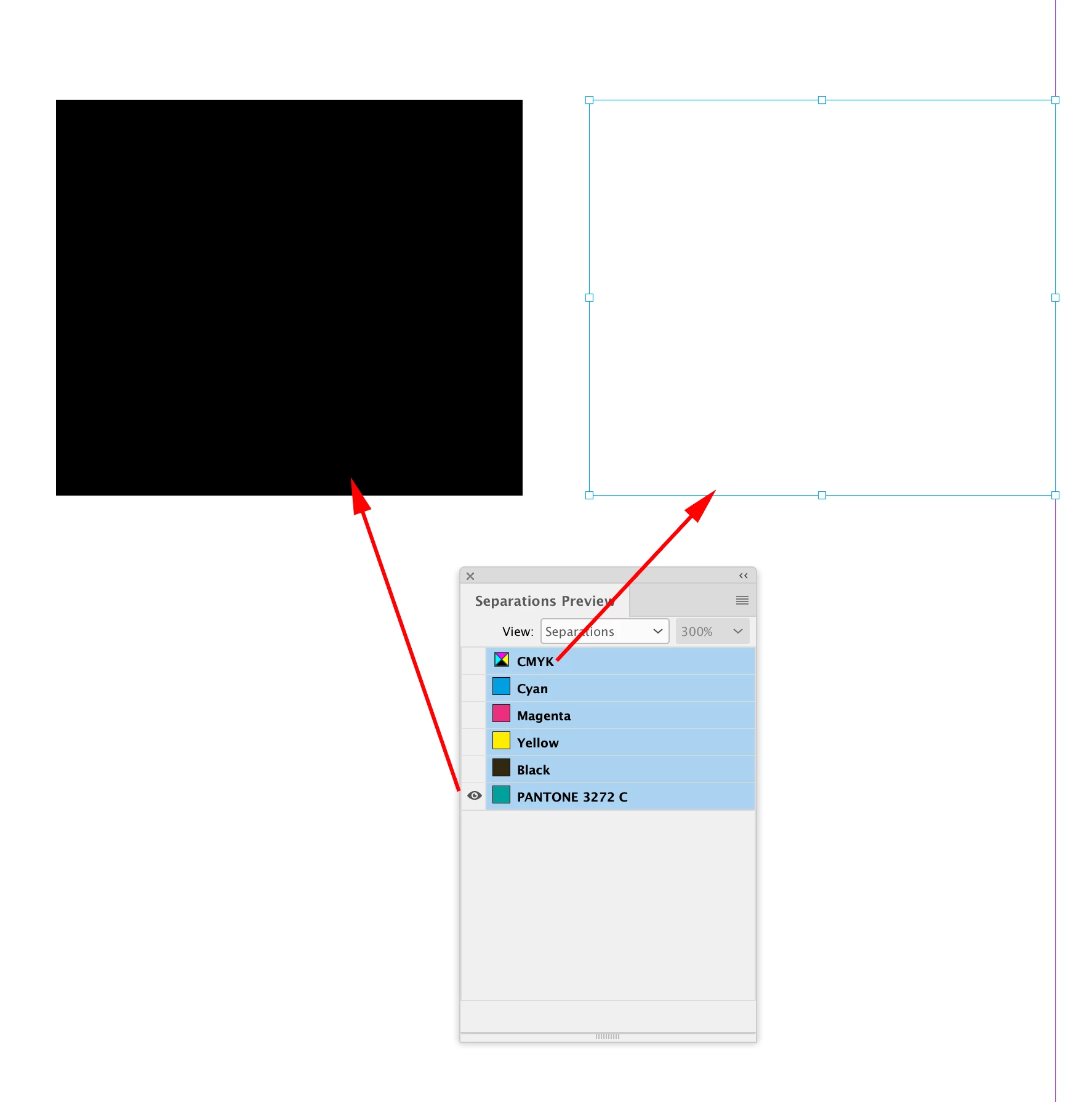

All the color for a 3-color job would have to be setup as Spot Color separations—process RGB or CMYK would not output to the Spot plates:
This is a Spot color:
This is a Process Color:
Process Colors output to the CMYK separations and Spot colors output to custom separations:
