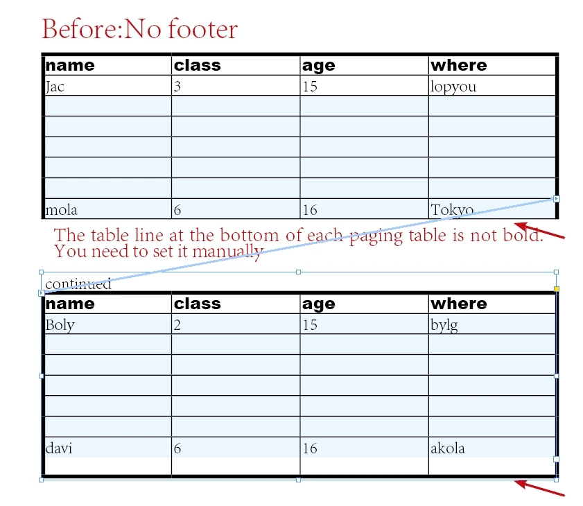

I often encounter long tables.
The table line at the bottom of each paging table is not bold. You need to set it manually
I see the footer function, but it's not perfect.

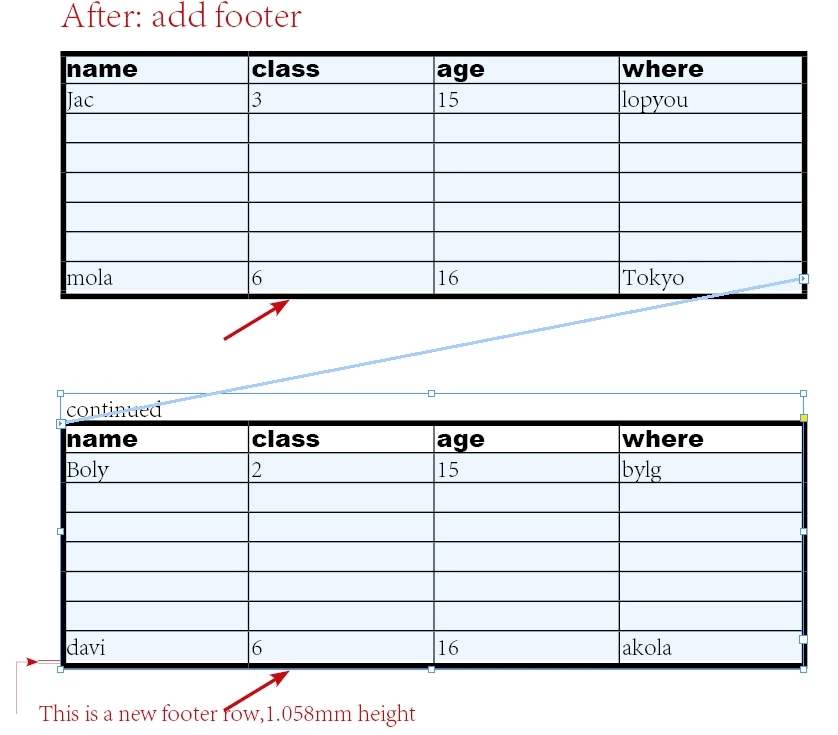

I want to achieve:
(1) Add a row at the end of the table.
(2) The top line of this row is empty and the bottom table line is 0.5mm.
(3) The row height is 0.1 (there seems to be a minimum row height of 1.058mm).
(4) In this row, the leftmost table line is 0 and the rightmost line is 0. The middle does not change.(Sometimes it is necessary to set the leftmost and leftmost table lines to none)
(5) Apply the cell style "footer" to this row.
It's annoying to do these locks. I hope experts can help implement them with scripts
Thank you very much.

I Use a diagram to show it
