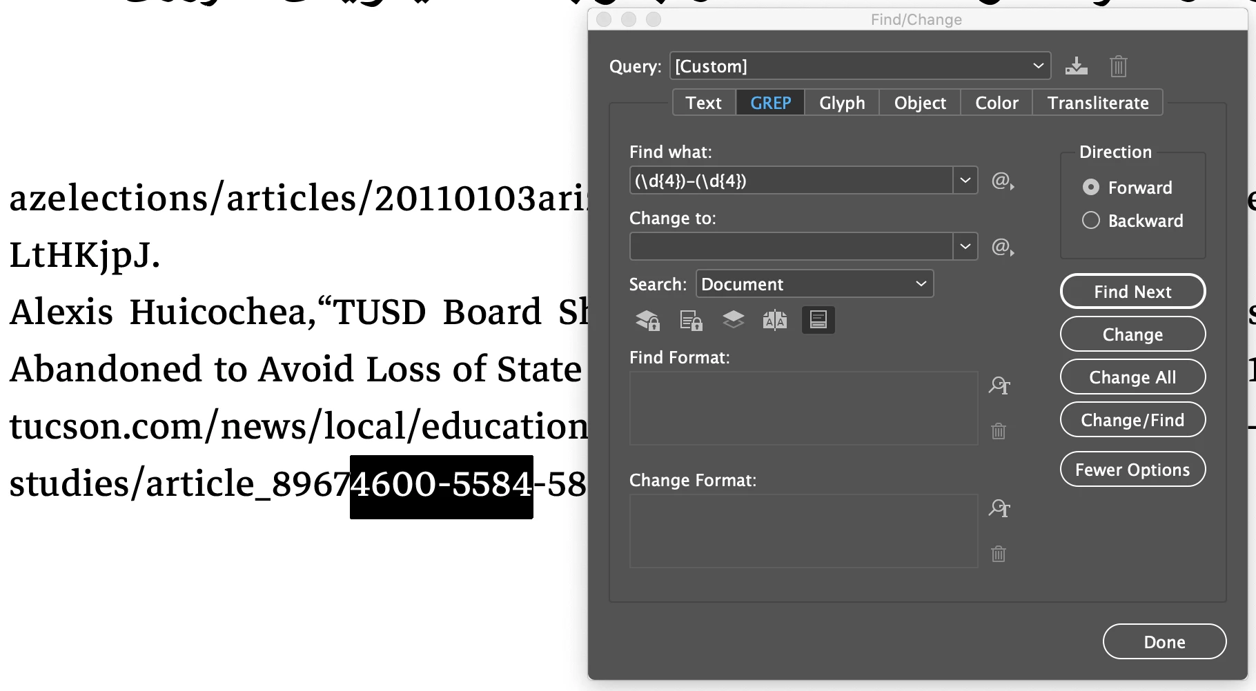

Thanks for your code. It works great, but there's a slight problem. The code doesn't look for digits only in the prantheses, as you see in the picture that it founded two four-digit numbers that are actually numbers of a URL.
The digits that only need swapping are in the parentheses. It must only go through the digits that are between parentheses, which means that (XXXX-YYYY) must be swapped, but XXXX-YYYY must not.
I tried to modify yours, but since I'm a newbie I couldn't.
LaubenderCommunity ExpertCorrect answer
May 4, 2022
Could you post the URL where this happened?
You could also use my suggestion for Find GREP that is a bit tighter.
For the script exchange this:
var f = "(\\d{4})-(\\d{4})";
with:
var f = "\\<\\d{4}-\\d{4}\\>" ;
Uwe Laubender
