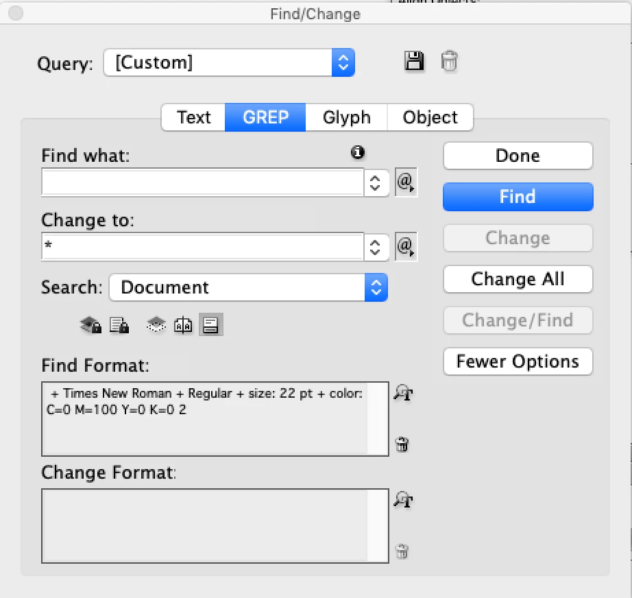

Hi, I have always wanted to do the following:
Find all text with a certain format and then add a special character in front of all instances of the formatted text.
For example:
Find format: Times New Roman + Regular + size: 22 pt + color: C=0 M=100 Y=0 K=0
and then I want to add an asterisk in front of occurrence of this format in my document.
Can this be done with GREP?
FRIdNGE
FRIdNGECorrect answer
Jan 6, 2023 5:38 PM UTC
Basically:
Find: .+
Replace by: *$0

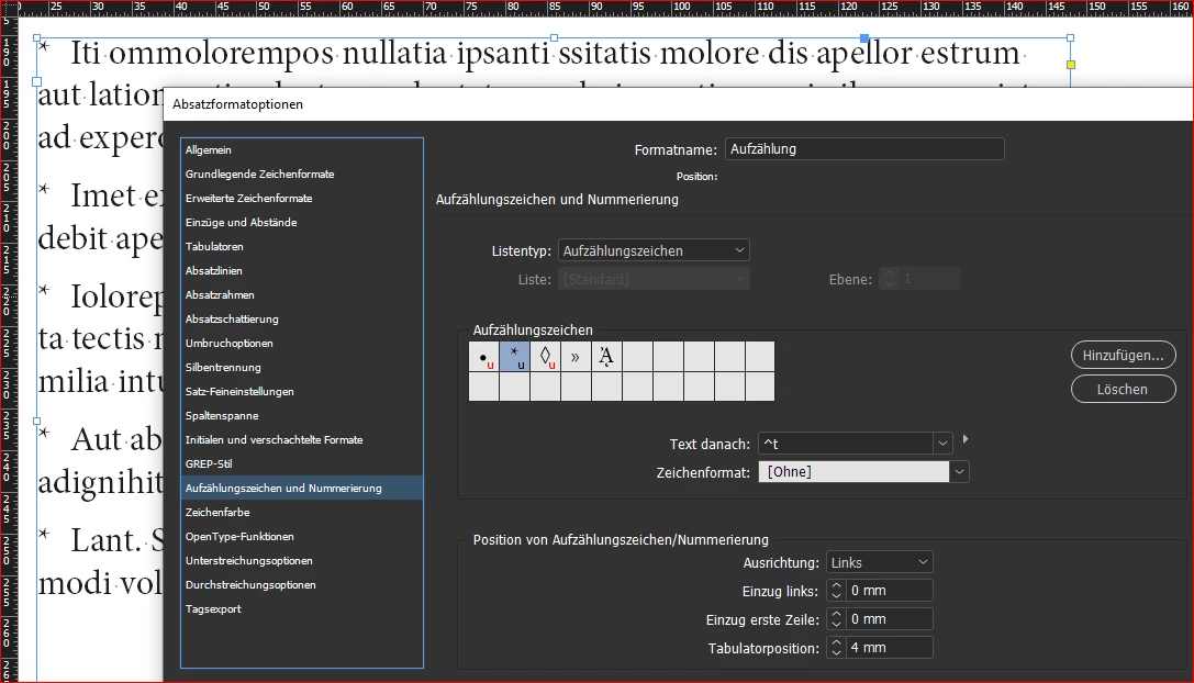

@Chris22040923b75s
Why not just activate the bullet and numbering function in your paragraph style sheet with the asterisk as a bullet?
Jan 6, 2023 8:09 PM UTC
Well, I just used an asterisk as a stand-in for any string of text I might want to do in the future.

Jan 6, 2023 6:39 PM UTC
Hi @Chris22040923b75s:
Note you need to enable GREP tab at the top of the dialog box. This won't work if you leave the default Text tab selected.
~Barb
Jan 6, 2023 6:53 PM UTC
Yes, that's correct. excuse my poor screenshot etiquette. I did switch the tab when I tried "the Jedi's" method.

Jan 6, 2023 6:51 PM UTC
Thank you! this did work.
