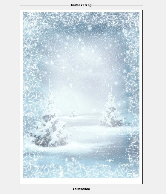

I have to Print a Document in A3, problem is I can't print the bottom 1,5 cm on the page (see attached file),
Tried all the settings, tried to export it as PDF, same result,
is that a Printer Problem (or Limitation) or I’m missing something?
W10 22H2, InDesign 18.0, EPSON SC-P5000
Thanks in advance for the support.

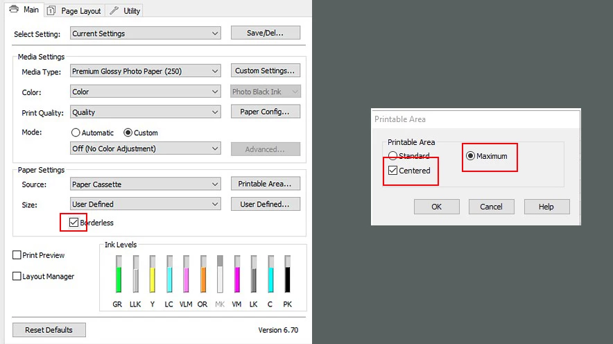

Correct answer Carmelo5FA3
*Final Update*
I was finally able to print to the entire (almost) A3 paper,
what does “almost” means?
Well, I was able to print with “0” margin on both right and left side and 3 mm margin on top on bottom part.
After looking for that on many forums, I realized that the 3 mm gap on both, top and bottom part, could be a printer limitation.
If someone found himself in my same situation, I leave the configuration that I used to achieve those margins.
I would like to thank Derek Cross and James Gifford for the effort to help me figure the solution.
Carmelo5FA3AuthorCorrect answer
November 8, 2022
*Final Update*

Little Update,
I tried to export the file as JPEG (to have more compression as possible in order to avoid filling the printer memory),
same result, then I switched to A4, same result, then I printed the same JPEG file from another Printer (OKI Printer that we use in our Lab for simple document), here is the difference

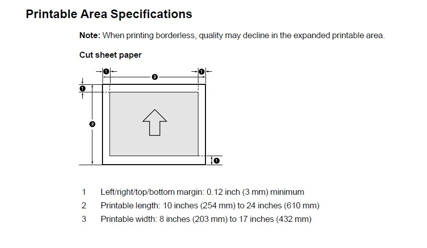

It may be the limit of your printer's printing area – check the documentation.
November 7, 2022
Hi Derek, thanks for the reply.
I checked the Documentation of my printer, and it says 3 mm minimum margin to each side, (top, left and right side margins are 3 mm), bottom side margin is 15mm.
Derek Cross
November 7, 2022
You should always print from a PDF created from InDesign, rather than directly from InDesign. The print doc margins look promising – are you sure the bottom bit of the image is missing?
