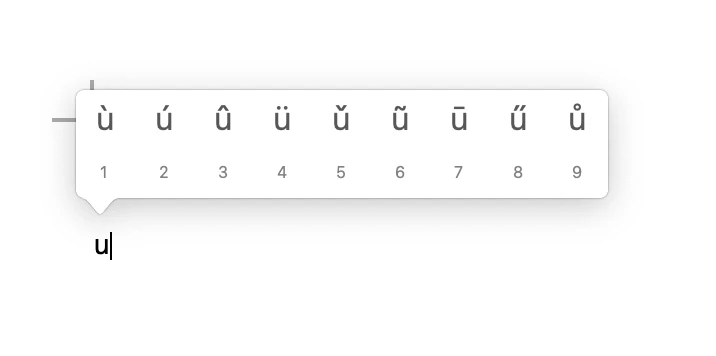

Typically, I write in both Japanese and English and for English input I use what is called ABC-Extended that lets me add macrons and such to the letters. This works in all apps (Word, Mail, Safari, etc) but it does not work in InDesign. InDesign does not recognize the ABC-Extended input and so I need to use the "Keyboard Viewer" to manually add special letters.

Normally, in Word, Mail, Safari (all other apps), I switch back and forth between Japanese input and ABC-Extended input. When in ABC+ if I depress an "e" key for a second, up pops a window with choices for all the "e" related diacritical marks. Same goes for all other letters that have diacritical marks in Unicode. However, in InDesign now, the issue is that if I depress the "e" key for a while I only get a long line of "e" characters. However, if I press Option + certain letters, I can add a diacritical mark to a letter in a two-step process. For instance, Option + "e" will bring up accent aigu (´).
