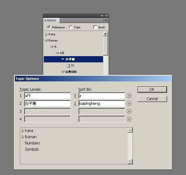

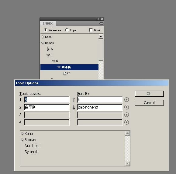

1.Collect the all index from the opened indesign document.
   This means collect all topics's name, sortorder, page reference in the index panel.
2.Change the sortby string of the collected index.
   This means change the topics's name and sortorder field of the top level only.
    I want the result like the following. From image1 to image2.

If I only change the sort order field of a topic, then the other topics with the same parent will also be changed.
So I delete all the topics and then add new topic which the sort order field and name field changed(page reference not changed).
In my case, is it possible only change the sort order field?
Best regard.
