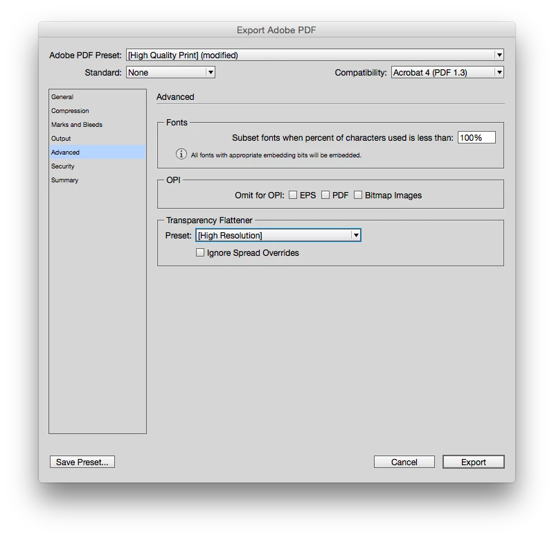

The High Quality Preset leaves color unchanged and keeps transparency live, and it may be that your Epson driver isn't handing the transparency flattening or color conversions correctly. When printing from AcrobatPro you should be able to choose a Flattener preset from the Advanced tab when you print.

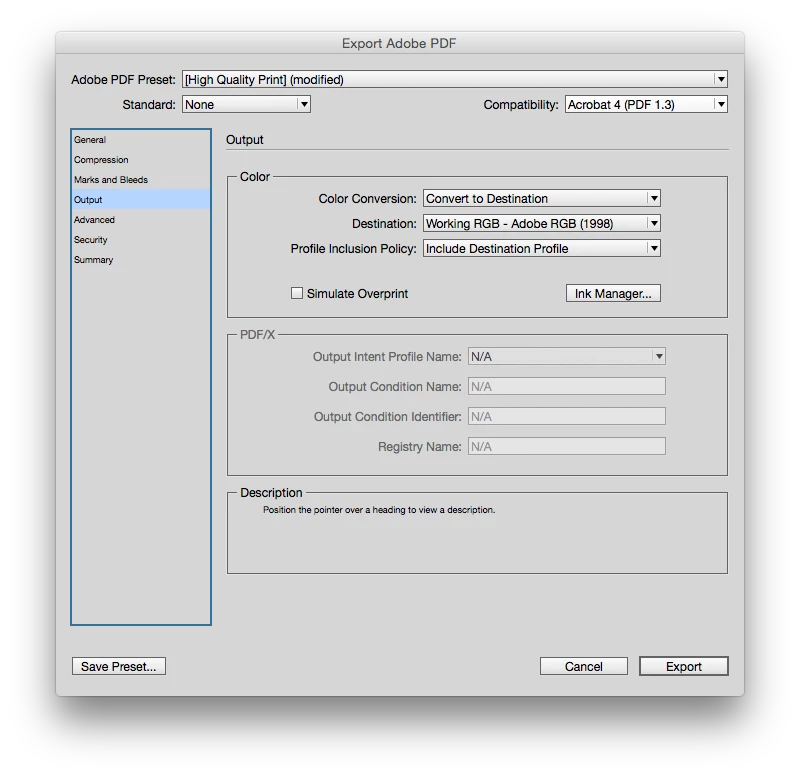

You could try handling the flattening and color conversion on Export, which would remove those variables from the mix when you print to the RGB driven Epson.
Flatten (Acrobat 4) and convert everything to AdobeRGB (or maybe sRGB in case the printer isn't honoring the profile):
And set at least a High Quality Flattener
