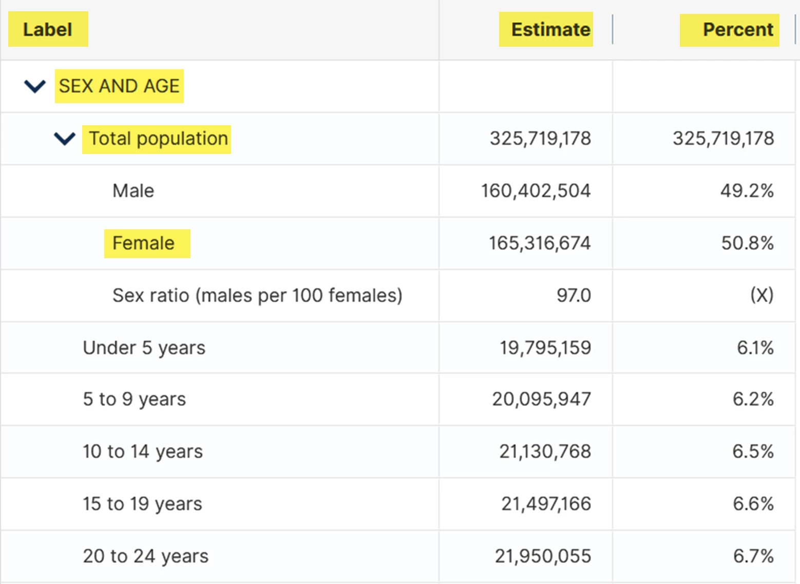

So all of your headings/headers must be tagged with a <TH> header tag because they are used by screen readers to identify the column or row the user is in. And they are read in sequence. Example: US Census table, total population of females.
<TH> Headers are highlighted in yellow that affect "female" data.
The voicing, when set to "default" settings by the user:
Label
Sex and Age
Total Population
Female
Estimate
165,316,674
But as Frans said, you'll need to set Scope, Span, and Cell IDs on the headers, and InDesign doesn't do a complete enough job on this. Note, the header "Sex and Age" must be merged across all 3 columns: Label, Estimate, and Percent.

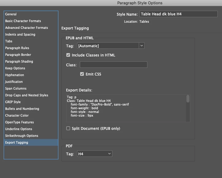

I had changed most of the paragraph style names (Black sub subhead H4 was from an older pdf) - should show in the "Edit all export tags" screenshot I sent earlier.
Just went through and shortened even more, eliminated a couple of styles and it's getting better. However I just found:
1. Tag H6 in InDesign, showing up as H4 in Acrobat.
2. Tag H5 in InDesign, showing up as H4 in Acrobat.

Frans v.d. Geest
January 10, 2023
By @Oriana808
 Then that H-level tag is set in the Paragraph style itself in InDesign or incorrectly mapped in the Edit all Export tag dialog...

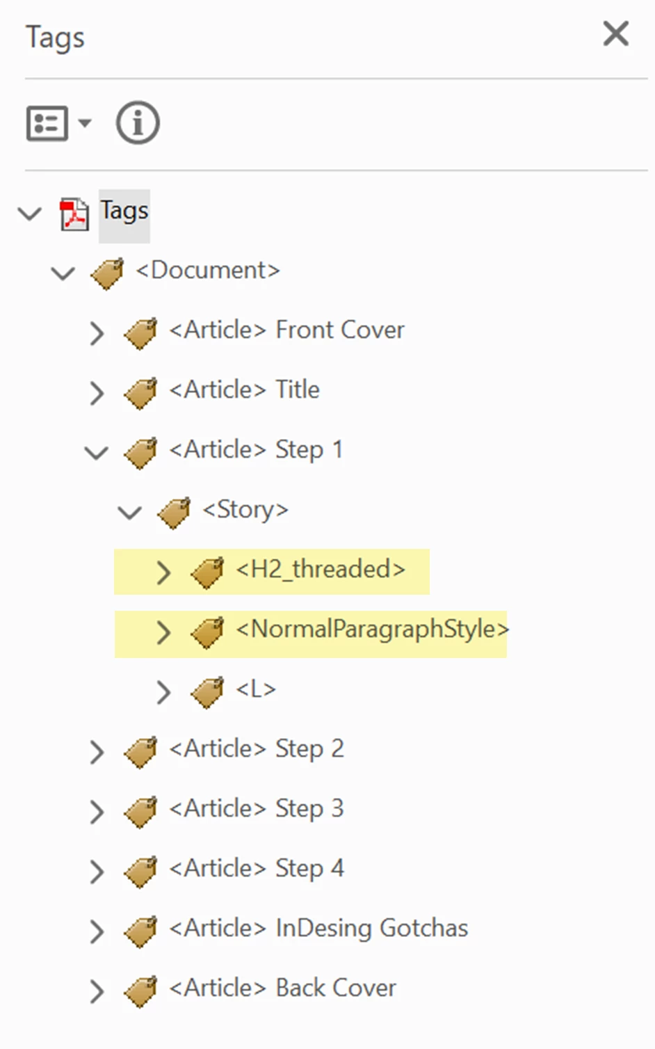

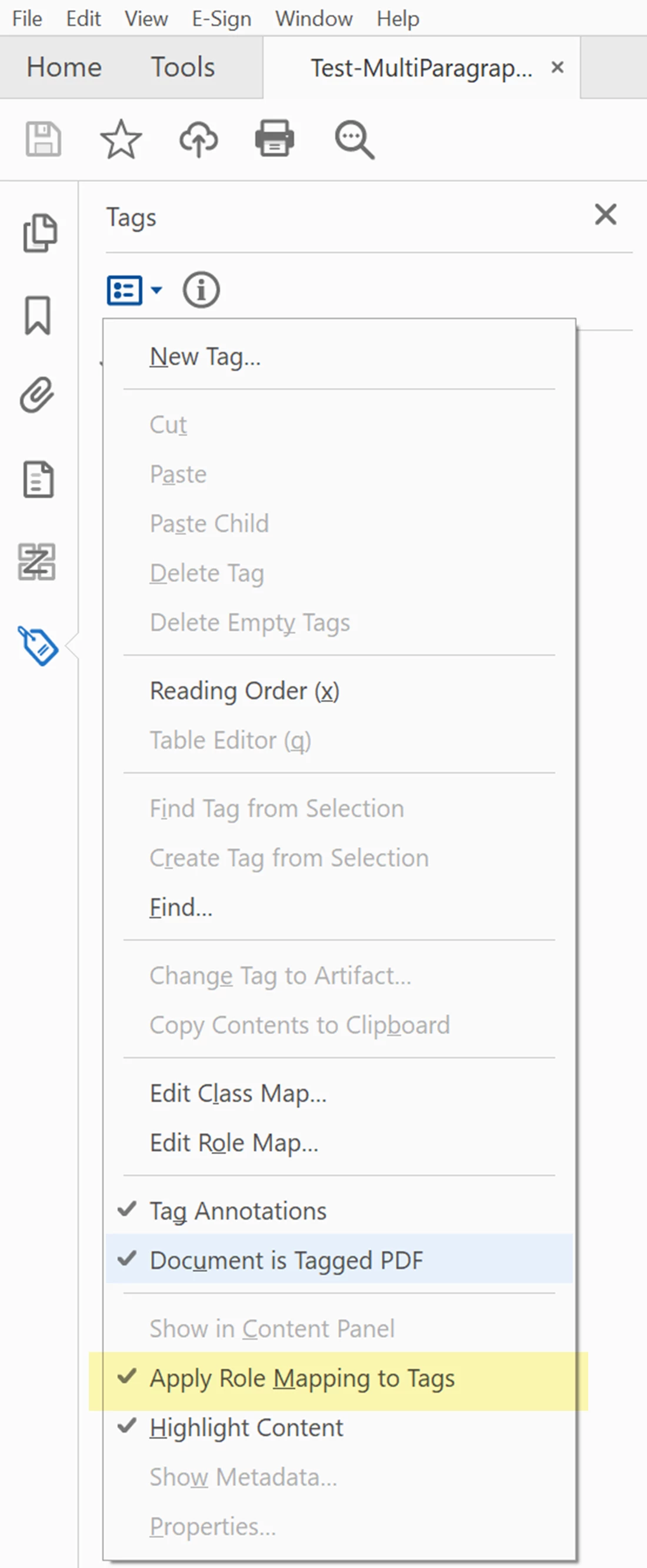

@Oriana808, you're seeing InDesign's "custom tags" in your PDF.
To change what you see and get the correct accessibility tags (H1, H2, etc.), turn on Apply Role Mapping in Acrobat. Here's how:
  1. In Acrobat Pro, switch to the Tags Tree panel.
  2. From the panel's options drop-down menu, select Apply Role Mapping to Tags.
  3. You should now see the correct tag names in the Tag Tree.

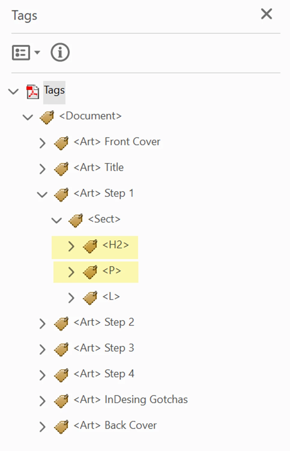

Before Role Mapping ...
After Role Mapping
|&nbsp;&nbsp;&nbsp;&nbsp;Bevi Chagnon &nbsp;&nbsp;|&nbsp;&nbsp;Designer, Trainer, &amp; Technologist for Accessible Documents ||&nbsp;&nbsp;&nbsp;&nbsp;PubCom |&nbsp;&nbsp;&nbsp;&nbsp;Classes &amp; Books for Accessible InDesign, PDFs &amp; MS Office |
Oriana808Author
January 6, 2023
Hi Bevi,
Yes I do have Role Mapping turned on. The issue doesn't effect all of the tags, just some of the tags. Also this doesn't solve the problem of incorrect tag structure - which is pretty serious as one wouldn't know if a tag was changed in hierarchy in a large document. Notice in one screenshot how it skips from H3 to H5. The other screenshot shows how the tags don't match between InDesign and Acrobat.
