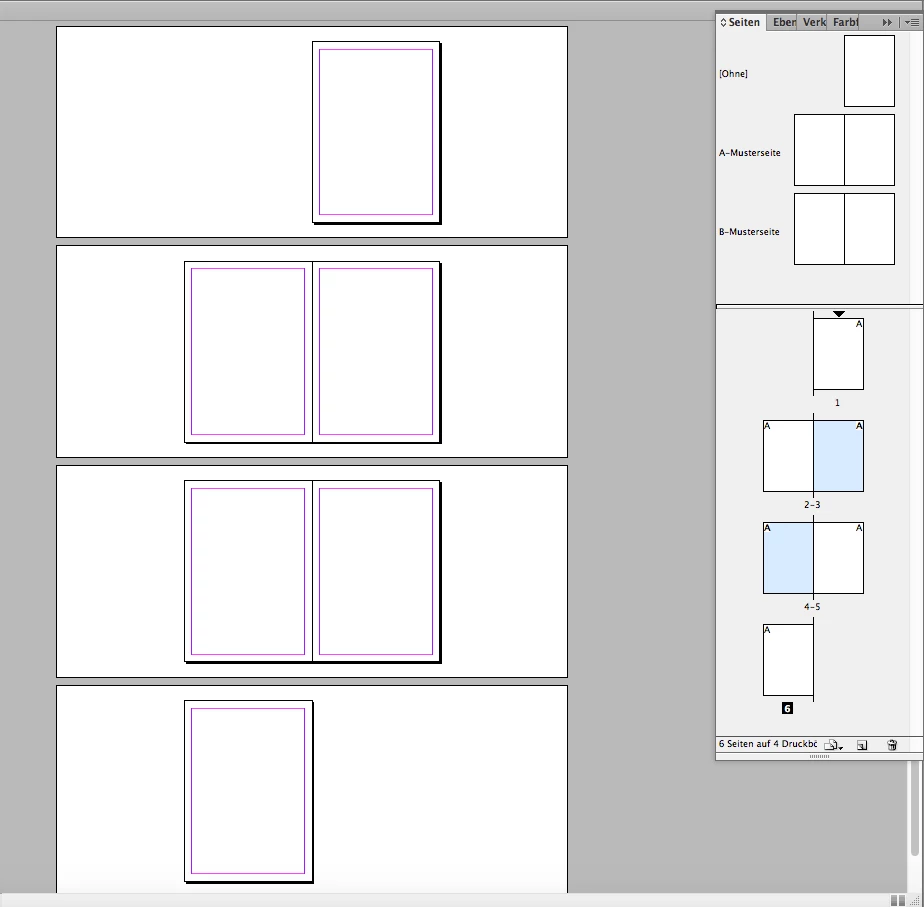

active page vs selected page
Hello to everyone!
I'm trying to find a way to get a reference to a page that is selected in Pages panel but not necessary is active one.
If I understand this correctly in the below example pages 2-3 are active even though page 4 is selected.
app.activeWindow.activePage - command will give reference to page number 2.
But what with page number 4? I can't find any method.
Thanks in advance,
jf

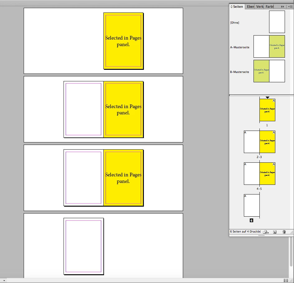

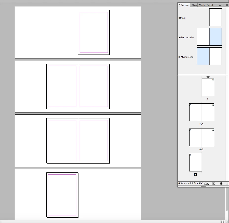

Hi together,
below some code that is looking for active pages in the Pages panel where the property pageColor is exploited.
Since pageColor cannot be applied individuallly on pages on a given masterSpread—all pages on a master spread are colored the same, if you apply pageColor to a single page, one cannot detect if a single page on a master is selected in the Pages panel.
However, for selected document pages the function is working as it should.
Notes and some important issues:
1. The code below is overwriting already set values of pageColor. It's up to you to refine it.
2. In case of selected master pages, one cannot tell the exact page, only the spread.
3. If the "None" master is selected, it will return an empty array.
4. It's for CS6 and above, because the menu structure changed from CS5.5 to CS6.
But it would be easy to do a version for CS5 and CS5.5 as well, I think.
Tested with CC 2017 on Mac OSX 10.10.5, but should also run on Windows.

	1. ISSUE | If a single master page is selected, all pages of the master are stored as selected.
	2. ISSUE | The script will reset all pages' pageColor to: PageColorOptions.USE_MASTER_COLOR
	ToDo:
	Get the initial state of pageColor for all pages and apply it again after retrieving the info.
	Or use several undos.
	3. ISSUE | CS6 and above

app.scriptPreferences.userInteractionLevel = UserInteractionLevels.INTERACT_WITH_ALL;
app.doScript
	addTextFrameToSelectedPagesInThePagesPanel,
	ScriptLanguage.JAVASCRIPT,
	UndoModes.ENTIRE_SCRIPT,
	"Add text frame to the selected pages in the Pages panel | SCRIPT"
// USE CASE EXAMPLE:
function addTextFrameToSelectedPagesInThePagesPanel()
	if(parseInt(app.version) < 8 )
		alert
			"SORRY:"+"\r"+
			"This is script can ONLY work with InDesign CS6 and later."
		return
	var doc = app.documents[0];
	var selectedPagesArray = getSelectedPagesInPagesPanel();
	for(var n=0;n<selectedPagesArray.length;n++)
		var textFrame = selectedPagesArray[n].textFrames.add
				geometricBounds : selectedPagesArray[n].bounds ,
				fillColor : doc.colors.itemByName("Yellow") ,
				strokeColor : "None" ,
				contents : "Selected in Pages panel."
		textFrame.texts[0].pointSize = 80;
		textFrame.texts[0].justification = Justification.CENTER_ALIGN;
		textFrame.textFramePreferences.verticalJustification = VerticalJustification.CENTER_ALIGN;

Jan 13, 2017 10:30 AM UTC
Hi Jarek,
I see a good chance for InDesign CS6 only where you can get the selected pages in the Pages panel.
For all other versions of InDesign—before and after CS6—there is a way to get the selected pages, but it comes with some severe problems. See the list below where I discuss this.
The solution is revolving around using menu commands with the Pages panel.
InDesign CS6 only:
Menu command with the key string:
"$ID/kOptionalPageMenuItem".
In my German version of CS6, this menu command is named:
"Optional in Liquid-HTML5".
What does "Optional in Liquid-HTML5" do?
It applies true or false to the page property optionalPage.
optionalPage was part of an experimental feature with InDesign's EPUB export function (as far as I remember) and is not implemented with all other versions of InDesign but CS6.
How could we use this feature?
You can check the value of optionalPage on every page and master page ( not the "None" master ) in the document before using the menu command and after using it. Therfore you can retrieve the selected pages in the Pages panel. If master "None" is selected one cannot use the menu command. We could detect this case by using try/catch for instance.
All other versions of InDesign:
For all other versions—where unfortunately "$ID/kOptionalPageMenuItem" is not available—one of the following three instances of the same menu command can be used. Depending on what exactly is selected.
"$ID/kDuplicatePageCmd" (German: "Seite duplizieren")
"$ID/kDuplicatePagesCmd" (German: "Seiten duplizieren")
"$ID/kDuplicateSpreadCmd" (German: "Druckbogen duplizieren")
There are other menu command strings available if you select master pages or all pages on a master.
Or one could use the menu command for removing pages. I did not fully test all the options available.
Problems are:
1. You have to undo what you did with the menu command.
2. If you undo the duplicating of the document pages:
2.1 The selection in the Pages panel is lost.
2.2 The active page will be a different one.
3. I had trouble—means was not able, not tested all ideas—to find the relevant locale-agnostic keystrings if all the pages of a master spread are selected.
No save bet:
Using the index of the menu commands to execute the associatedMenuAction.
3rd-party scripts or plug-in could have installed other menu commands in the list before the one you are trying to use.
Uwe

Some screenshots:
Case A, document pages selected in the Pages panel.
Before running the script:
After running the script:
Case B, master pages selected in the Pages panel.
Uwe
