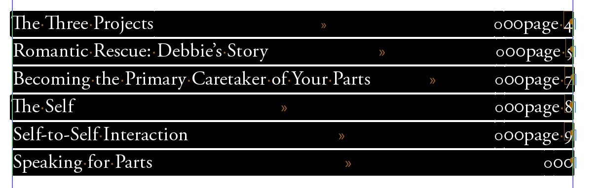

Hi Everyone,
I need a help with this. I am trying to add crossReference to the text selection on the page, script will find the selected entries inside the text and will add PageNumber CrossReference. But it doesn't iterates the last entry.
Throws 'Object is invalid.' error. Can't find what is wrong with this. Please check and help me find what's wrong with this. Please refer the screenshots attached.
var myDoc = app.activeDocument;
var xRefForm = myDoc.crossReferenceFormats.item ('Page Number');
var tocEntriesPstyles = []
var CrossSource;
var CrossRefDest;
var tocEntries = app.selection[0].paragraphs;
for (var l = 0; l < tocEntries.length; l++) {
var eachentry = String(tocEntries[l].contents)
eachentry = eachentry.replace(/\t000\r/g, "")
CrossSource = myDoc.crossReferenceSources.add (tocEntries[l].paragraphs[0].insertionPoints[-2], xRefForm);
app.findTextPreferences = NothingEnum.nothing;
app.changeTextPreferences = NothingEnum.nothing;
app.findTextPreferences.appliedParagraphStyle = myDoc.paragraphStyles.item("ah")
app.findTextPreferences.findWhat = eachentry;
var myFoundItems = myDoc.findText();
if (myFoundItems.length > 0) {
CrossRefDest = myDoc.hyperlinkTextDestinations.add (myFoundItems[0], {name: myFoundItems[0].contents});
myDoc.hyperlinks.add (CrossSource, CrossRefDest);

Hi @m1b,
Thanks for your valuable response.
Yes after reversing the loop it works. However, it leaves atleast one entry behind without adding cross-reference(throws error so it has to skip that entry).
Sathish
FRIdNGE
October 6, 2023
\t000$\r?
