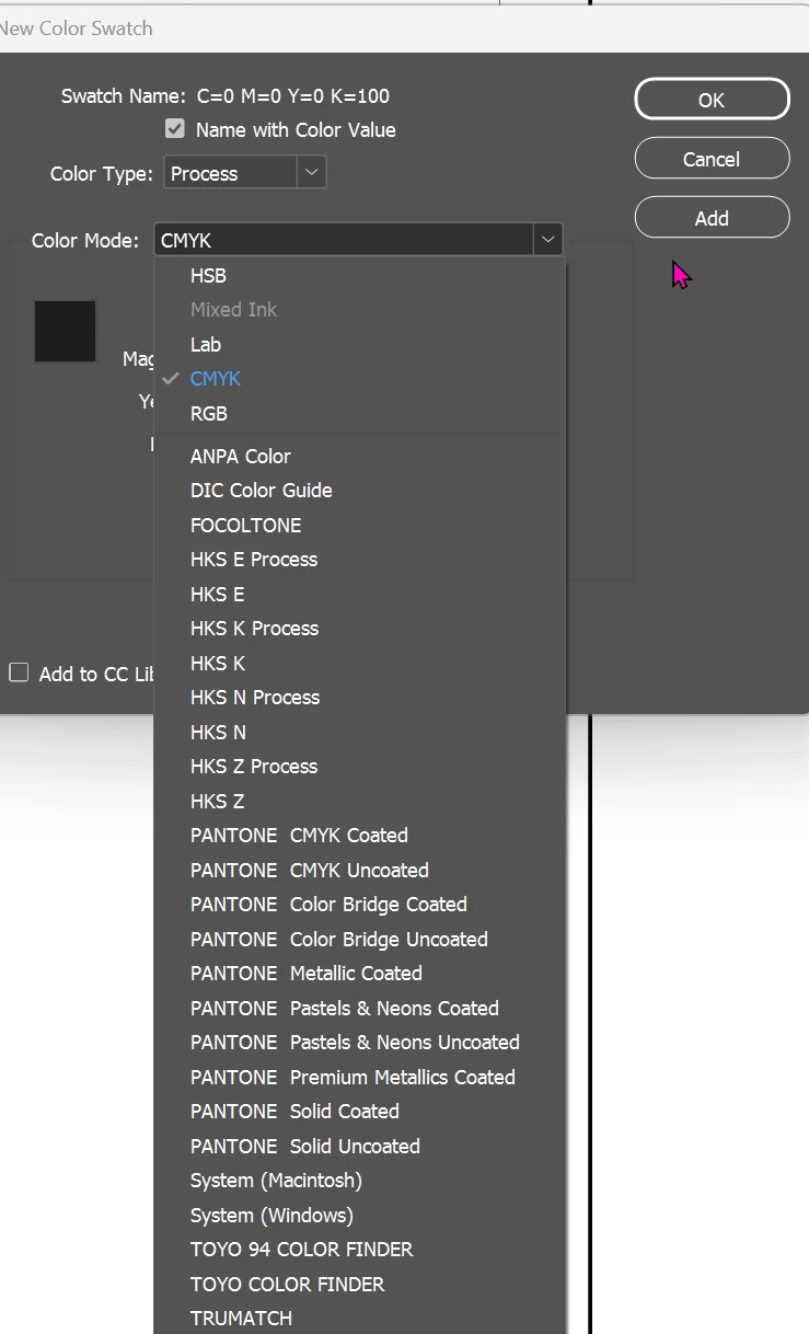

Adding Pantone swatches?
Since they removed the Pantone library from the color swatch section, what’s the easy way to add a swatch? I read several threads about this from years past but all the solutions are now deprecated...

    As ​@Dave Creamer of IDEAS says, if you still have the old Pantone libraries installed with another Adobe application or an older version, you can copy those libraries across and continue using them where they’re compatible.
    The important limitation is that they’re legacy libraries. They haven’t been updated in years, so they won’t contain newer Pantone colours. Pantone itself says the old Adobe libraries are missing more than 800 PMS colours. So they can be perfectly useful for existing work and older Pantone references, but you could encounter a colour in a new project that simply isn’t there.
    And just to clarify why they disappeared in the first place this wasn’t Adobe suddenly deciding that designers shouldn’t have Pantone libraries. Pantone and Adobe ended the old bundled-library arrangement and moved current Pantone access to Pantone Connect. Pantone describes it publicly as a joint decision because the bundled libraries had become outdated, while some have said at the time that Pantone wanted the libraries removed so it could charge customers directly.
    Either way, the end result is the same what used to be bundled with Adobe applications was replaced by Pantone’s own subscription-based service.

    Since 95% of my work is in CMYK, the main libraries I use are the Pantone CMYK libraries (not the Color Bridge spot-to-process ones). Luckily, CMYK doesn’t go out of style and as long as I keep the guides in good shape (mainly keeping out of the light to prevent fading), they still work.
    My understanding is that Pantone wanted to get in on the lucrative software subscription market. They were not making as much with the original agreement with Adobe so they increased the cost. Adobe balked at the increase and Pantone started their subscription service. (They have a limited free version, but for full access, you need to pay.)

    You can add the swatches if you can get the libraries. I have the old (original) libraries and the Pantone Plus libraries. If you need them, DM me by clicking on my name. I believe ​@Mike Witherell  is working on a much more extensive repository.
