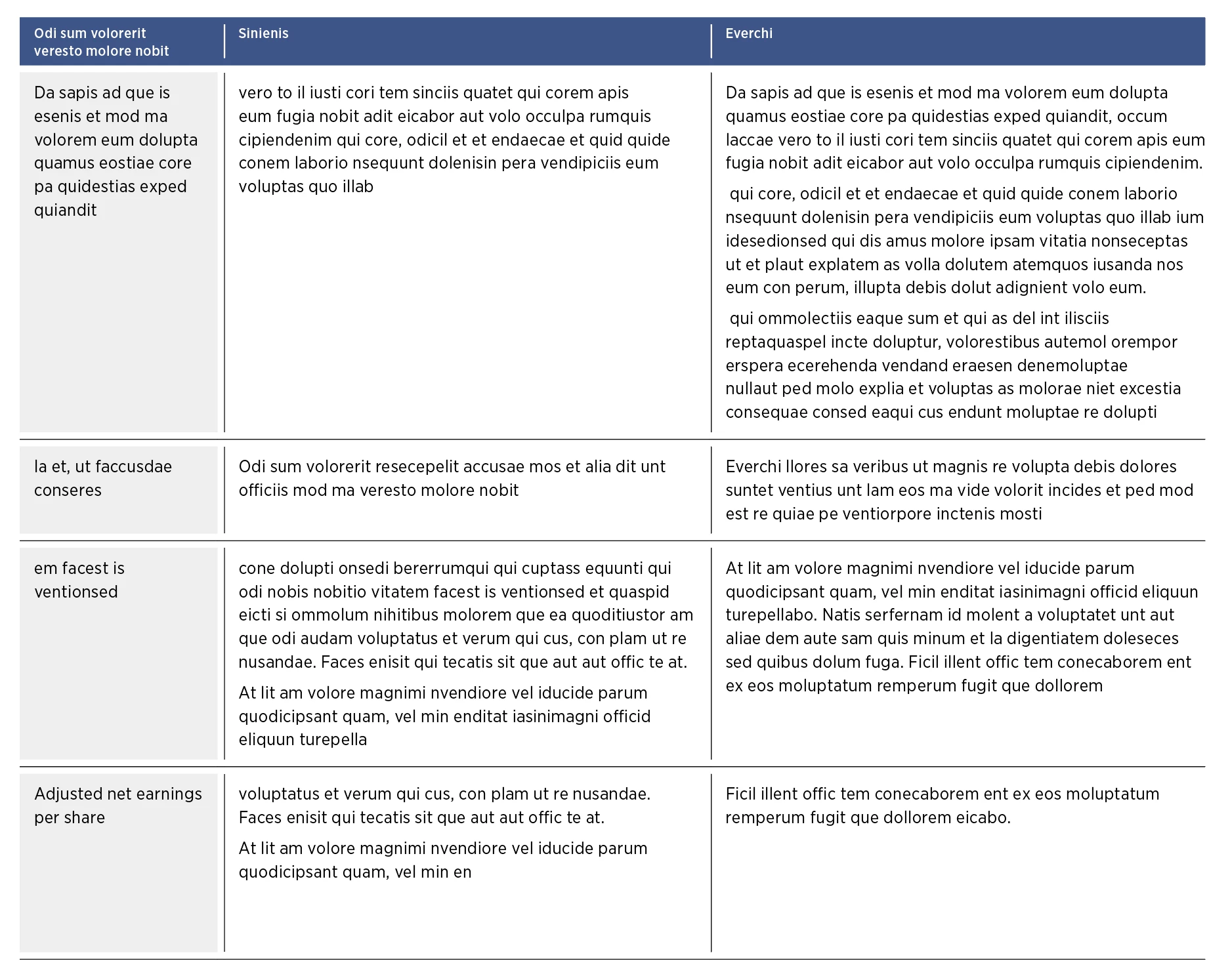

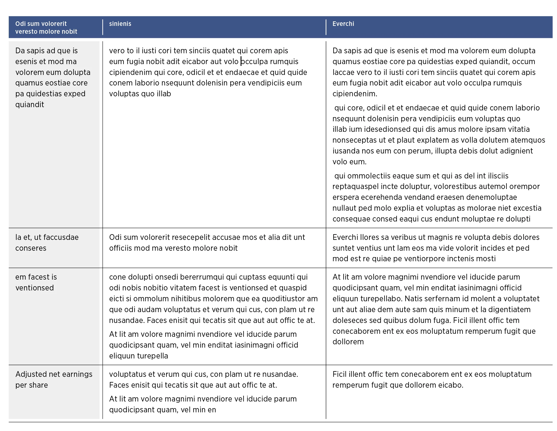

HI,
I'm having trouble modifying a table. I need to add 2 rows between each existing body rows to get the look of the table right. Here's what it's supposed to look like.
and here is what I'm at right now.
 As you can see, I get pretty far, but I don't know how to add rows from the second row (initial rows) to before the last row of the table. The number of rows will vary from table to table, so I need a way to count the number of rows of my selection, but everything I tried to increment that fails. It's like once I add a row to the table, my initial selection is not valid and it's like the selection is the document, not the table.
Anyway, here's my script that does what you can see in the second image.

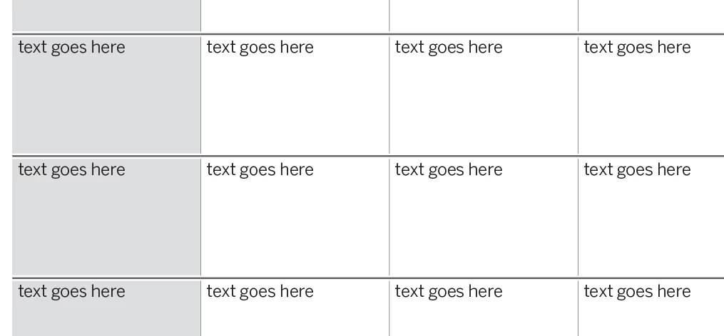

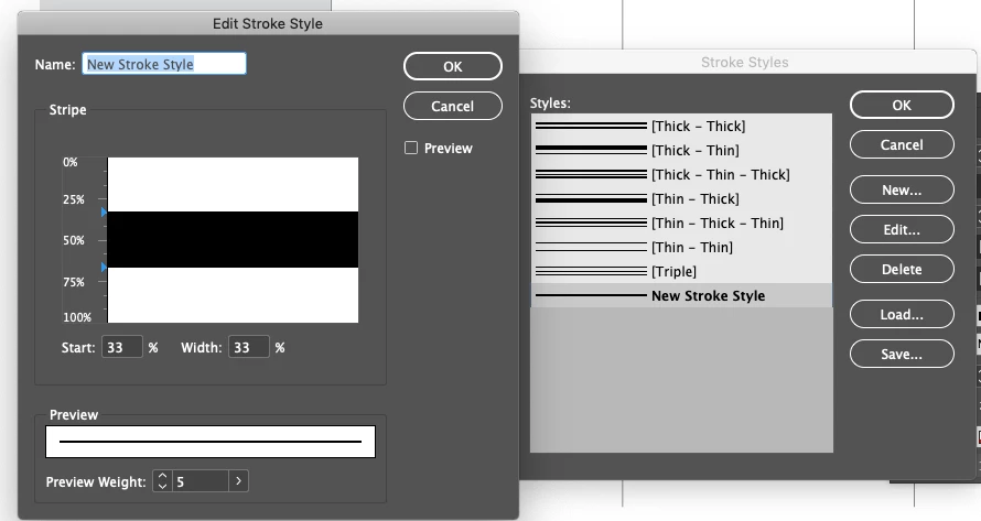

    As an alternative to scripting the solution for the rows, you could instead create a custom Stroke Style with the black line in the center and the white parts on both sides (something along the lines of this screenshot). Here a link to Adobe's Help site for creating stroke styles.
    Applying the stroke and adjusting the stroke width (you'll likely need to make it thicker than the current stroke since the black part is only 1/3 of the width) will get you this far, and you'll only need to add the column to the left of the first column, which you've already done with your AppleScript.

    Thanks David,
    I ended up modifying my script and used the stroke style method for my body rows. I couldn't make one that was working correctly for between my header row and first body row though, it always showed a little white line even if there was nothing. I'm sure it wouldn't have shown on prints, but since the document has to be made in pdf also, I couldn't take the chance. So I ended up putting 2 rows to do the job there, but those were easy enough.

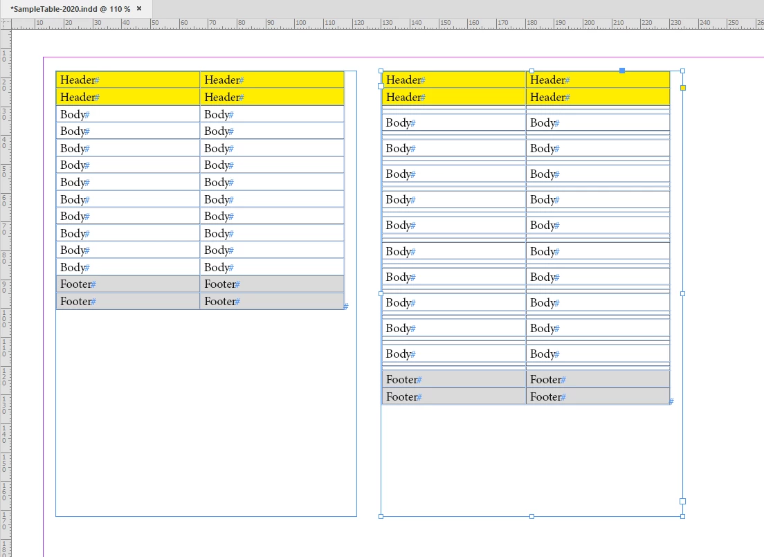

    Here a screenshot of a sample table showing before and after running my script on the selected text frame:
    Uwe Laubender
    ( ACP )
    March 13, 2020

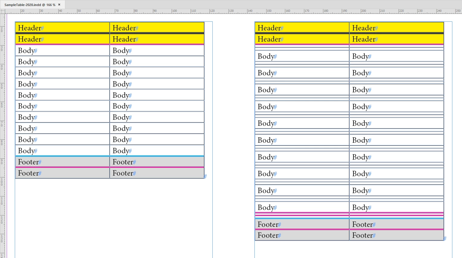

    If I change the table a bit so that you can see custom strokes in header and footer, you also can see what InDesign is doing when adding rows before or after a destinct row. It actually transfers the properties of the rows. So you want some more properties defined with your added rows:
    Also note that there is a minimum height of a cell or a row.
    Means: You cannot set the height of a cell or a row to e.g. 0 mm.
    Even if your insets for top and bottom are set to 0 mm.
    Discussing this further, to get the minimum row height that is possible, you have to do two things:
    1. Set top and bottom inset to 0.
    2. Reduce the point size of every cell even if there is no text in the cells of the row.
    3. Also consider the value of row.minimumHeight
    Just to give you some hints if you try to set the height of a row and the applied value will not work as expected.

    March 13, 2020

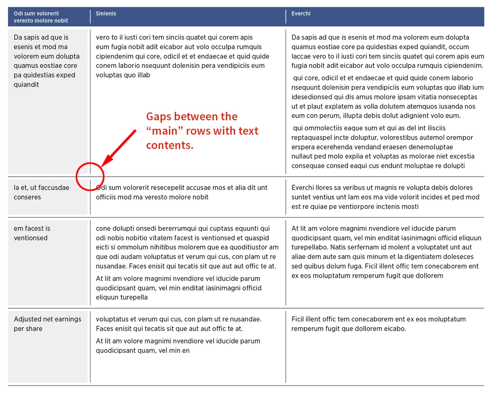

    Scott said: Perhaps I'm missing something, Jeff, but I see no difference between these two tables.
    Hi Scott,
    first I thought the same, but then I noticed the gaps between the "main" rows with the text contents:
    I wonder if we could achieve that design without adding rows.

    Scott Citron
    March 12, 2020
    Perhaps I'm missing something, Jeff, but I see no difference between these two tables. Regardless, I suggest you move this post over to the InDesign Scripting forum.
